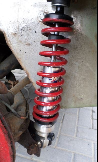

Dave from Dampertech is sorting stuff out for me regarding the shocks. Now about the spirng rate for the rear, would 125 also be enough?
I took the old out of the rear, and this one is very dead.
14"open
10" closed with a pen mounting on top.

I fitted these to my Series 3:
AVO PA 160/105 - 16" open 10.5" closed with stem top
Springs 10" free length 175lb
A vast improvement over the original Zimmerites.
Guest JimmyRH
Thanks for the image en info.
I have just ordered a custom set of GAZ GP Range @ Dave from Dampertech.
14"open, 10"closed.. Mine has a different top mounting box at the top. Otherwise 16"would have been perfect.
I ordered 200LBS springs with them.

Guest JimmyRH
And they have arrived :) I have fitted the rear ones yesterday, the front ones I will start on today, this is a bit more work with the stainless steel bar in front.

Guest JimmyRH
Got them all fitted up in te car, the front was terrible to reach, even had to disconnect the radiator and coil to get the bolts out but they are in. In the front I have them a bit lower then before, the rear is the same height. But now, I am struggling with the set up.. on the screw is a - and a + I have started in the middle and have been testing with +2 towards the +.. and been doing this for a few times now but I can not seem to get it correct.
I believe I have it to hard, on asfalt, no problem.. but on a brick road, my teeth are coming out and my kidneys have dents in them.. Not really sure how to set them and is - or + softer?? kinda lost. I think specially the rear is the working area.
I followed Niduncan and used the original rear springs on Gaz shocks and 125lb on the front
i took the wishbones off and drilled the top mount hole for the new metric bolt and also had to drill the bottom holes in the chassis.
on the front I have only 3 clicks from minimum and get good suspension movement
Guest Brian spencer
Just been playing with mine on a 2b with wishbones on front and gaz shocks seem to have 5 complete turns from - to + so started at 2.5 turns ( half way ) still a bit hard so backed all off 1 more turn and now lovely and comfortable ride maybe not track race settings but very nice to drive now,I was loosing teeth before 😬. So in short terms I’m set 1.5 turns from from full  - position .
