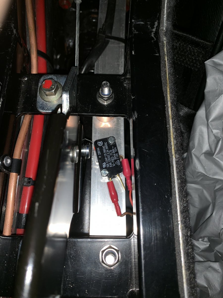

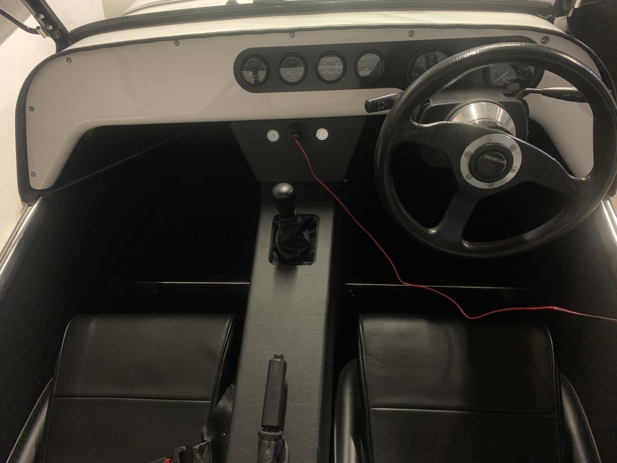

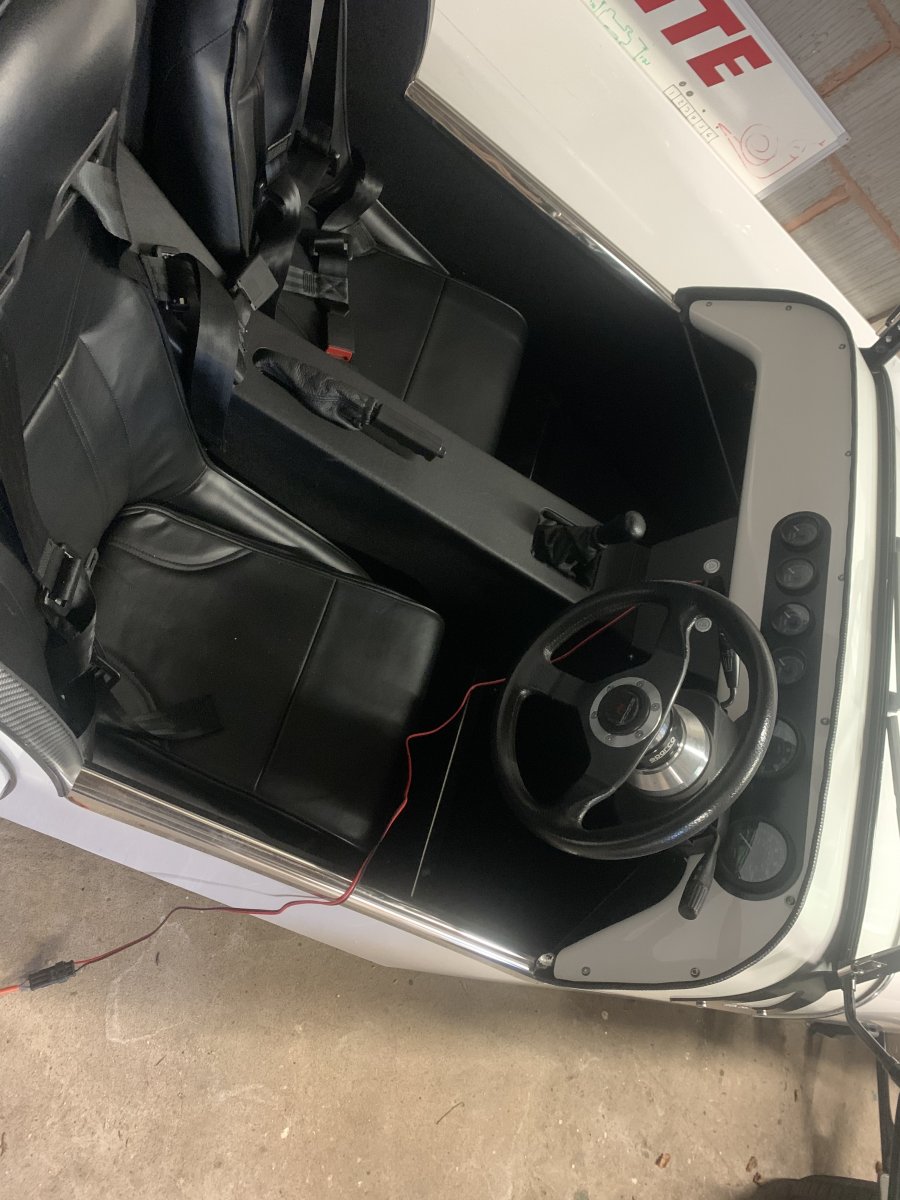

I made a new set of alloy covers for the tunnel and dash from 2.4mm thick alloy so it’s far stronger than normal and doesn’t bend when you lean on it. Then put countersunk pins from top and clamped the gators between the covers and a surround underneath. This leaves an extremely  neat and tidy finish that is also strong and durable.
I also remounted the handbrake switch when I was on, the normal location is terrible at best.
