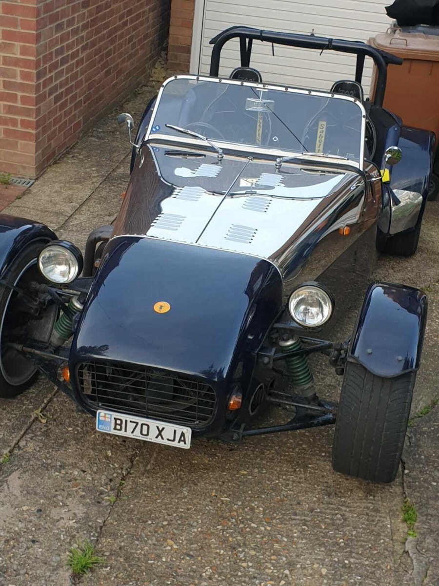

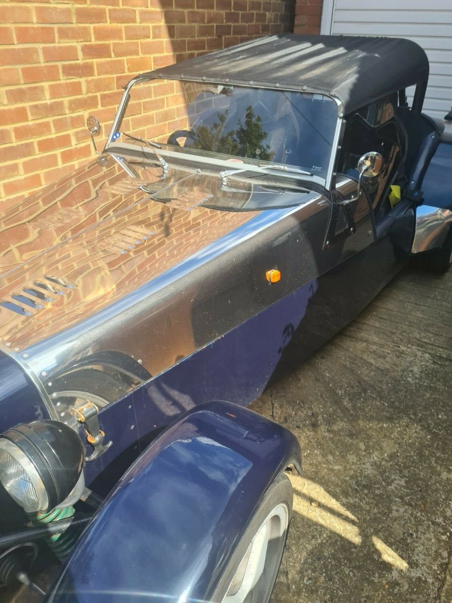

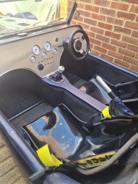

Looks like it’s be to me.
you can see the slim line tunnel, alligator bonnet, the round tube on the floor.
suspension looks correct.

Thanks for the quick reply.  I have bought this car and it is being picked up on Tuesday.  Had a mad moment as the advert did not say what it was and I assumed it was a 2b.....

The 2B plus had the double wishbone suspension as in your photos.
The standard 2B was a slightly different design known as a sliding pillar Where the spring was separate from the damper but both were mounted In a near vertical Position beside the front wheel.
