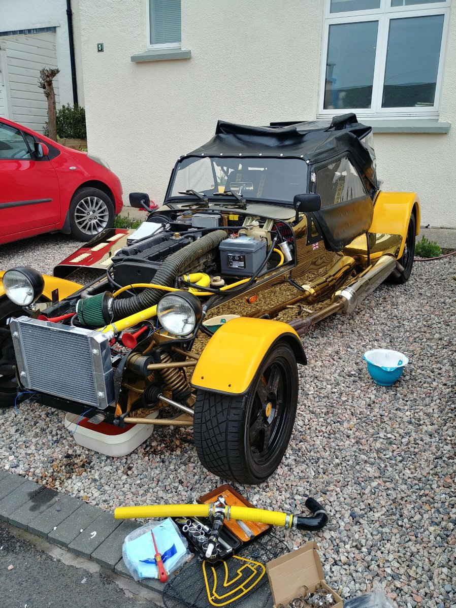

Do people fit radiators in the space in front of the engine, or in the space between the two frame rails above the steering rack with a rear tilt?
Mine is between the frame rails and is the original rad from the donor sierra....Not very sexy, but happily cools a 2 litre zetec
Random, sorry, just getting over a spinal op....... Will have a hunt around ....If nothing on file will go up there the morrow and then post
This is an old piccie  ... .I inherited this set up..... It's not sexy but it gives you an idea . I am going to change it at some point
