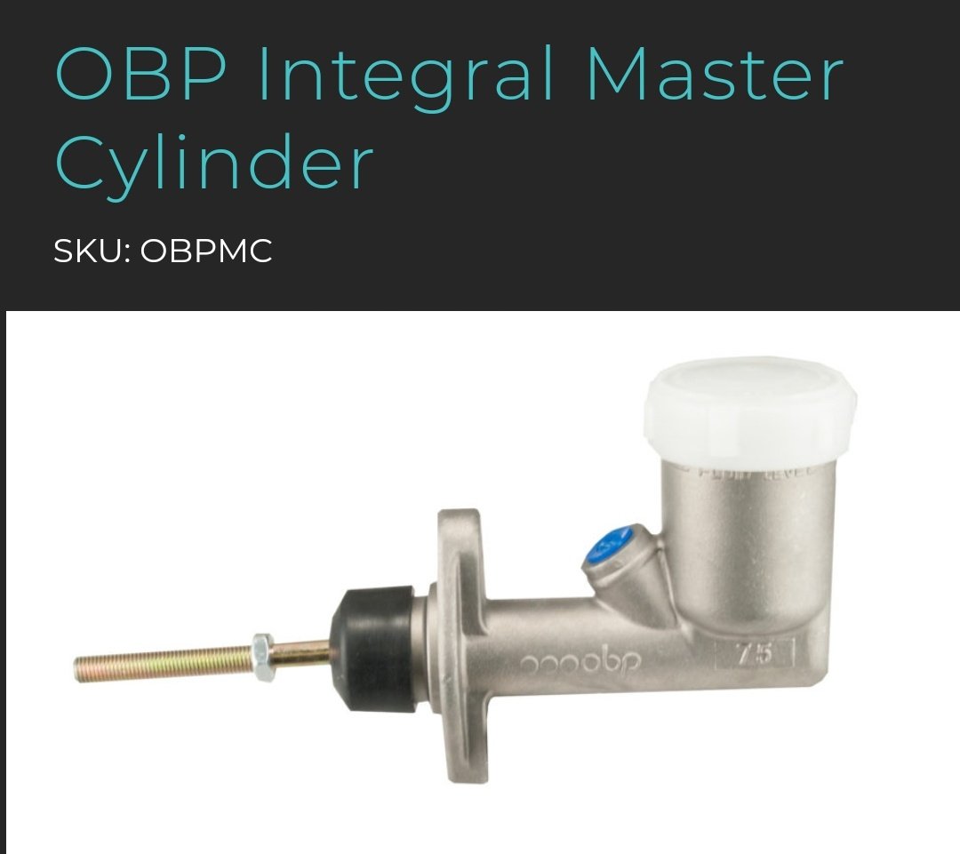

I then moved onto the master cylinders…..
The original plan was to mount the fluid reservoirs up on the scuttle area,  This was causing plumbing issues and space issues.  Plus it just looked a bit rubbish.
The hoses from the master cylinders were getting caught in the pedals and the reservoirs themselves were high up and causing clearance issues with the bonnet.
Plan B was to mount the reservoirs directly to the cylinders for the brakes, but the clutch cylinder is very close to the chassis rail and will have to be remote, which for just the one reservoir is not an issue.
cQwsAjtSecCOEaIl1g4jr0iayNyOdYiSMA66EMvvMa5Zva7Cgb4obaycR1qrJghwXW763k95PcSJU8yPNPiA6RD_rvd2cJYtMlVOzNo7Vb_qSAe3ns6mR0Y8ZbUrozUVO2JcmCTW
This all fits nicely with enough space around the reservoirs and the caps fit on easily.

For the clutch, you could use a master with a very small integral reservoir. It looks like there is space down there?
Something like this?
