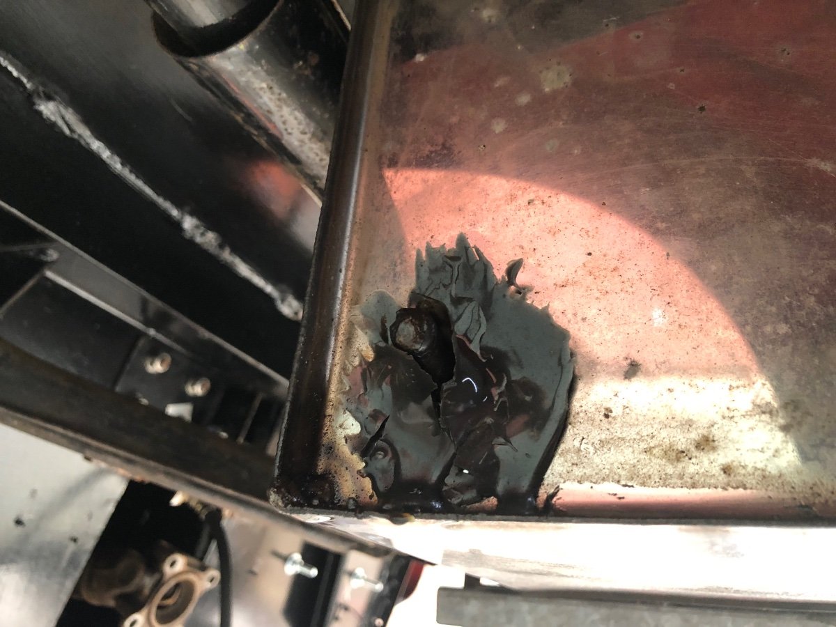

I also had a leak in the petrol tank.
Tank looks just like yours. Leak was actally from a crack in the seam.
I removed tank and emptied it.
Painted aircraft fuel tank sealer round the seams on the inside ( do all seams as leaks travel ) PPG 1440 2 part sealer.
It is expensive but it has held for over 20 years. I got it cheap as it was a couple of days off time expired. Now retired and these expensive solutions might not suit your finances.
