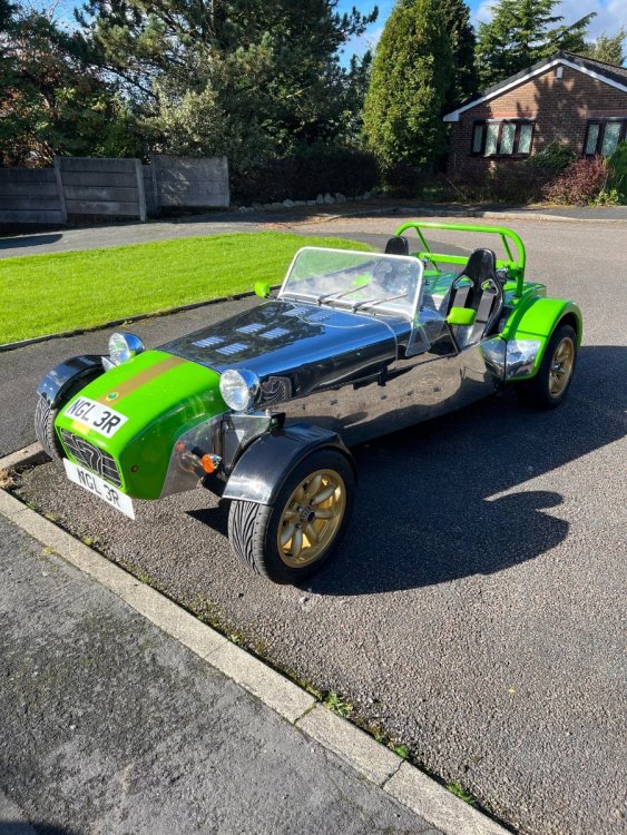

Has anyone swapped the long sweeping front wings for shorter ones?
If so did this affect turning circle and/or meant changes to suspension?

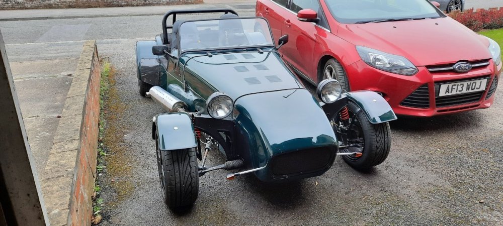

It has been done many times.
How depends if you want the wings to turn with the wheels or just be fixed straight ahead.
I do not recall any one doing what I would call a good job of stearing ones. Others may differ.
Some cropping of the suspension tops and judicious cuts to the fiberglass have given a reasonable result to fixed straight ahead wings. This should pass MOT as most production cars have parts of thier wheels out in the open at full lock.

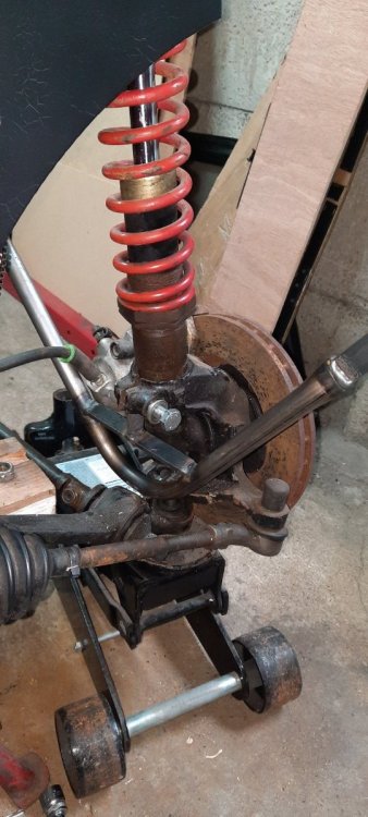

I have done this using these from kit card direct. They need a bit of modification but work well and allow wings to steer with the wheels.
 http://www.kitcardirect.co.uk/cycle-wing-bracket-front-wing-stays-for-billet-aluminium-upright-black-single.html
The front suspension buttresses also need trimming a bit to allow the wing to sit across the width of the wheel.

Thanks for advice, steering ones look best, I have seen other non-steering solutions but they sit quite height to avoid turning wheels and suspension travel.
I will post pictures in and when.
