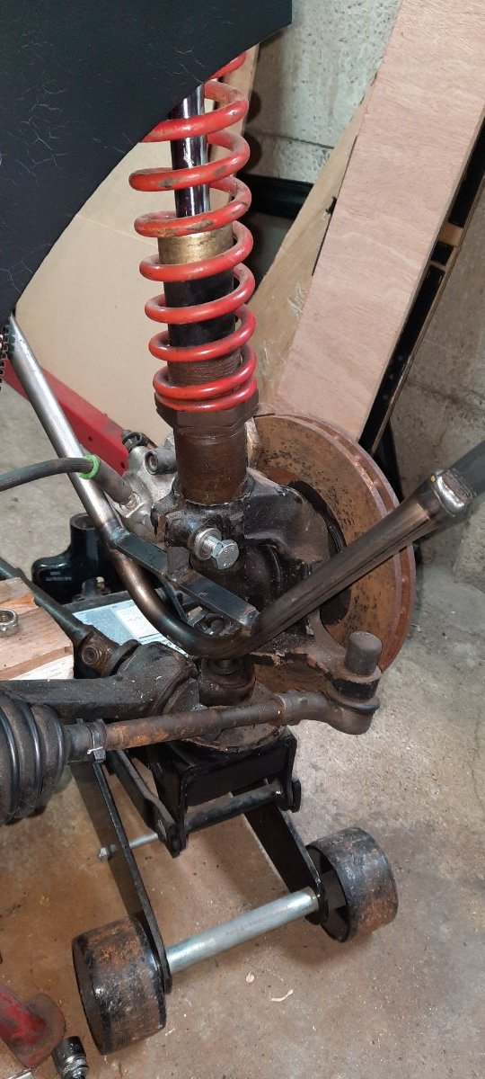

I have done this using these from kit card direct. They need a bit of modification but work well and allow wings to steer with the wheels.
 http://www.kitcardirect.co.uk/cycle-wing-bracket-front-wing-stays-for-billet-aluminium-upright-black-single.html
The front suspension buttresses also need trimming a bit to allow the wing to sit across the width of the wheel.
