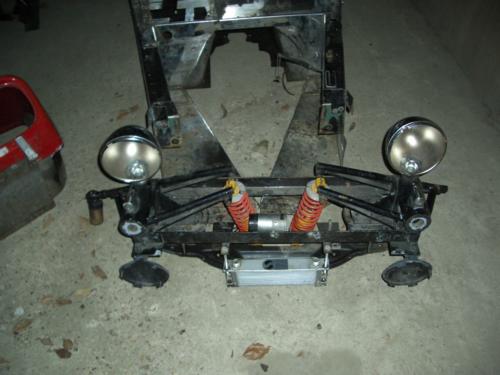

Hi guys,
I bought an S7 about a month or two ago after it had been dismantled,yet the instructions are in parts and so I'm pretty much building it blind!At the moment I want to make it a rolling chassis,and was just wondering about the suspension.It has internal shocks with Robin Hood upper wishbone arms,and uses the Cortina subframe; it has McPherson struts for the front.I was just wondering whether it uses the Sierra trailing arms and which other components for the suspension.Any help would be great.....it's a Mark 2 S7

Harry I suspect the subframe you have will be the early sierra one with the bottom arms on and an angle iron frame to bolt on the top to take the top wishbones. a cortina subframe is huge with both wishbones, springs and shockers attached. goodness knows why you have Mcpherson struts though. Take some pictures to post on here and why haven't you come to the Baldock meetings yet! The next one is the christmas meal though.

Cannot upload pics,there is something wrong.I will send them to you though if you think you can help me
Good luck with the test Harry, and the A levels. I will PM you with my home email address if you wish to send some pictures. To post them on here they have to be under 50kb, the easiest way to do that is to use Matts image sizer.
