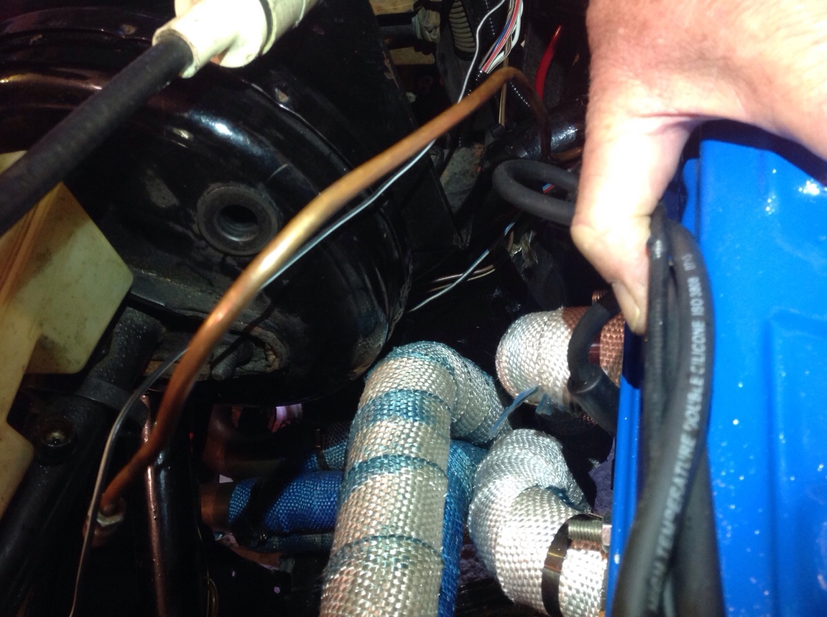

  10. I've managed to alter the plate the servo it mounted on, so I've got about an inch clearance. I'm interested in ditching the servo though timbo! Is it literally a straight swap for the fiat cylinder?
  11. Will the brake servo be effected by the heat from the exhaust manifold being this close? Is there a rubber diaphragm inside? Cheers

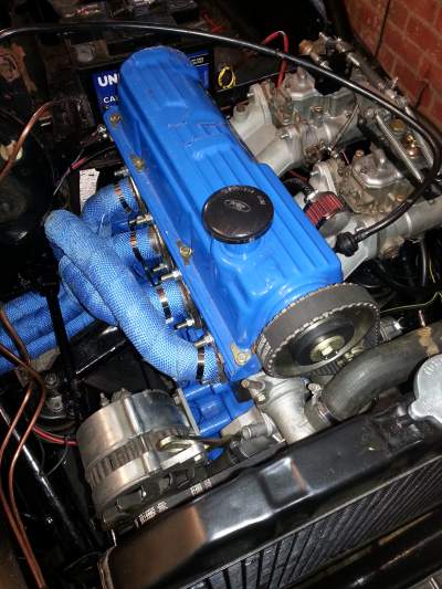

  17. 2 Ltr 205 Pinto Big Valve Head RL31 Cam 45 Weber's Wiring left to do, should be on the road end of May (fingers crossed)
