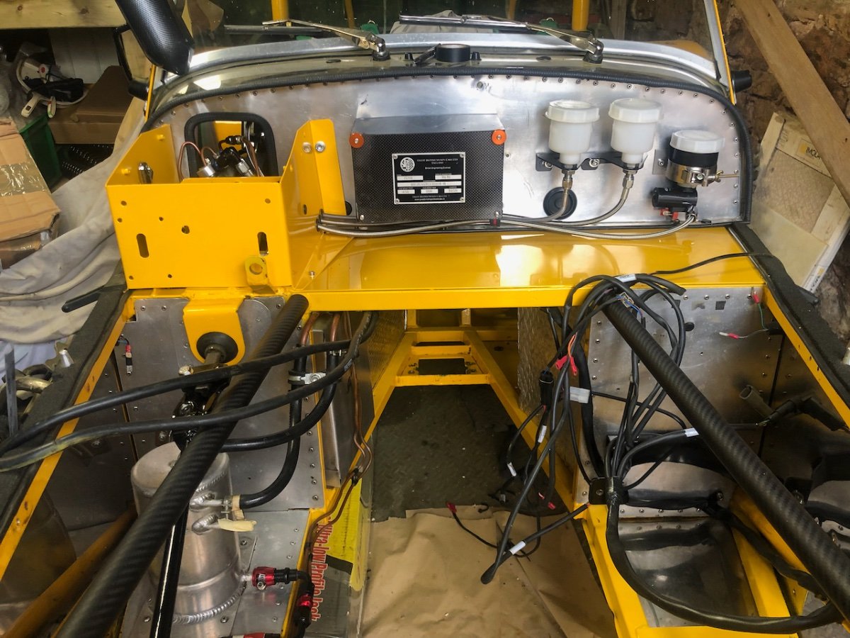

Almost completed my Gen1 Zero nut and bolt rebuild and want to prime and bleed Fiat 128 dual master cylinder with remote reservoirs.
Is there a particular in which I do this?
Any help would be gratefully received.
The attached image shows siting of reservoirs. Thanks, Craig

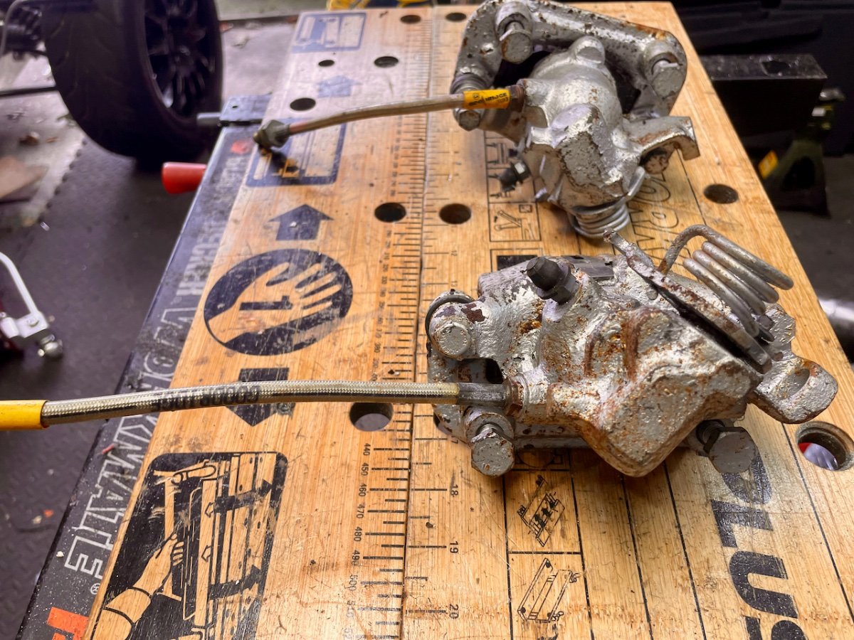

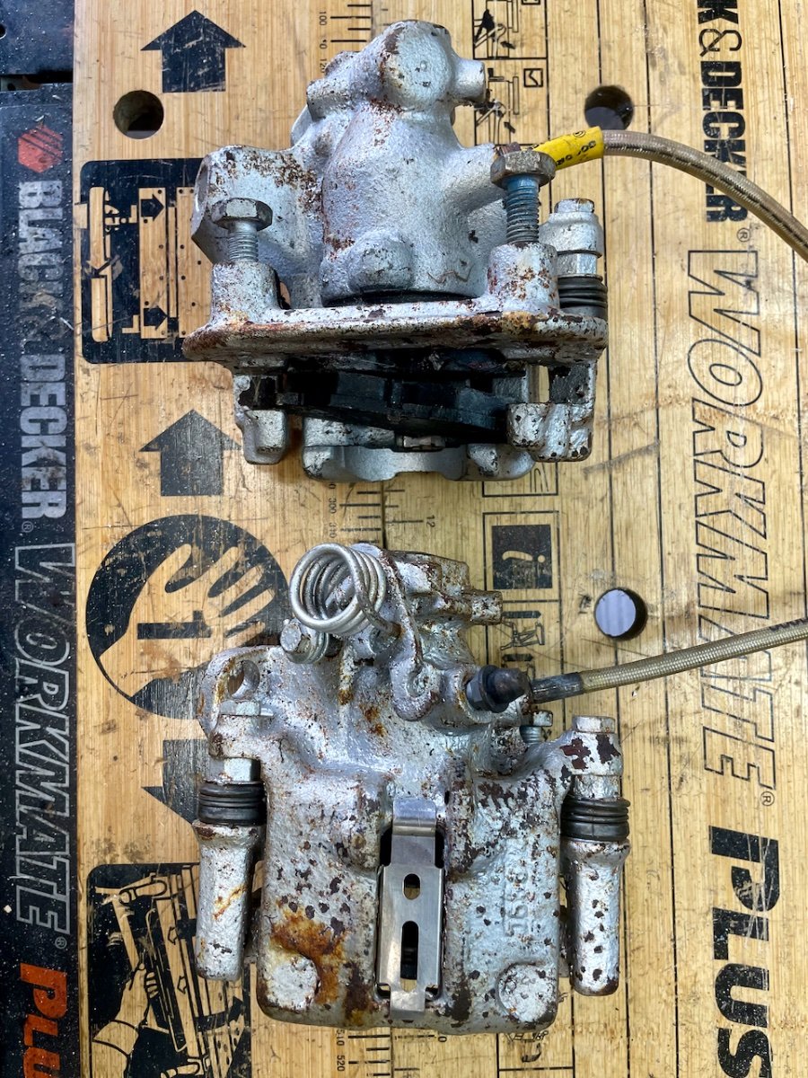

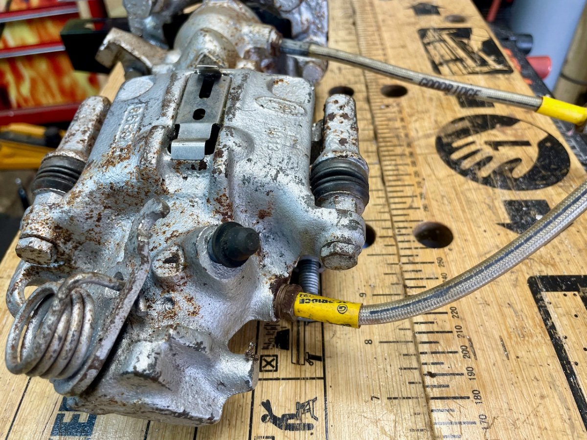

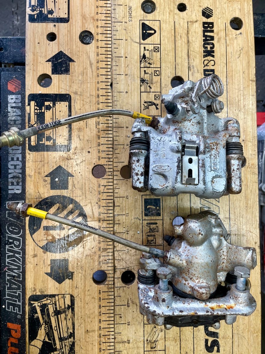

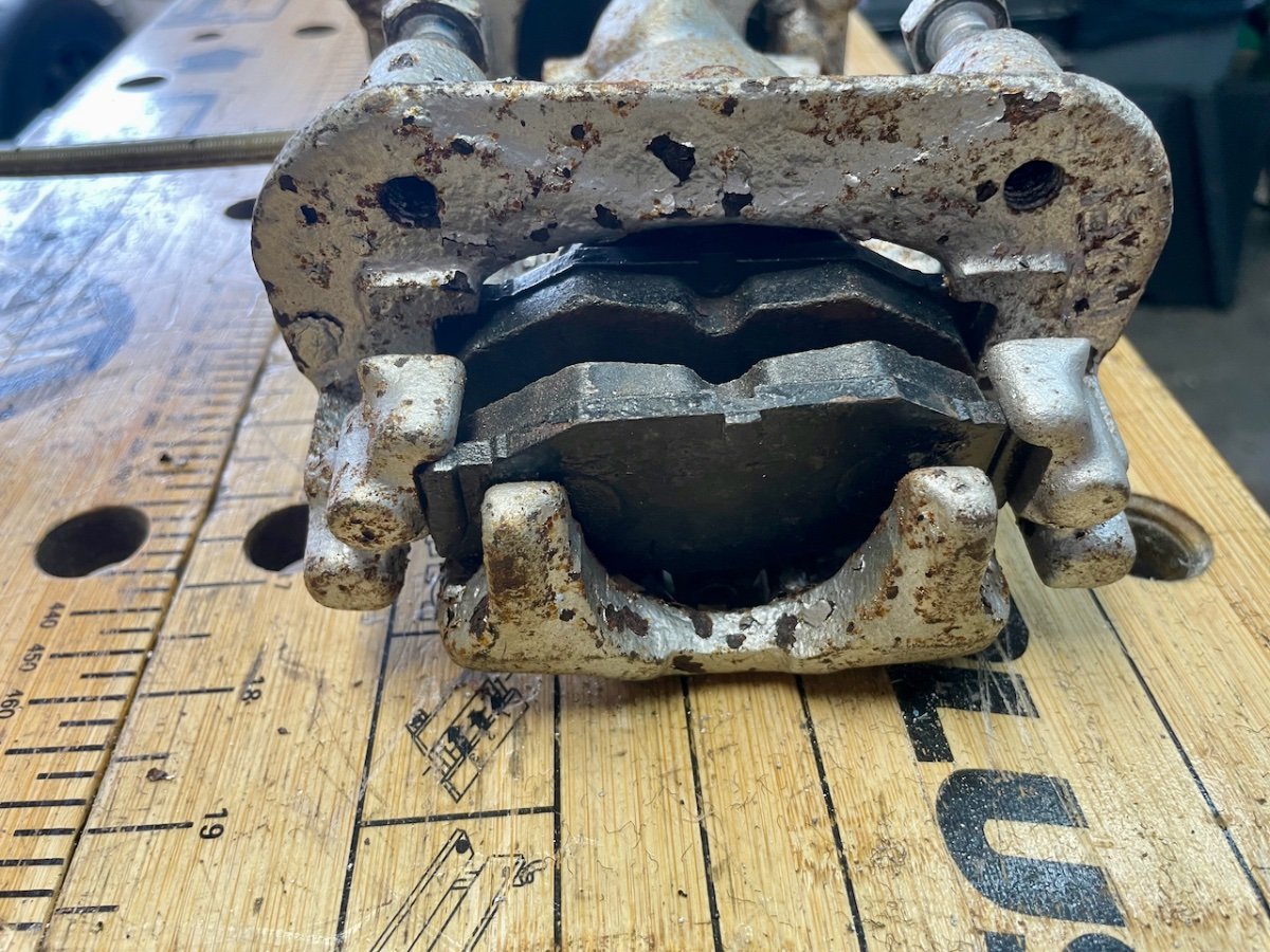

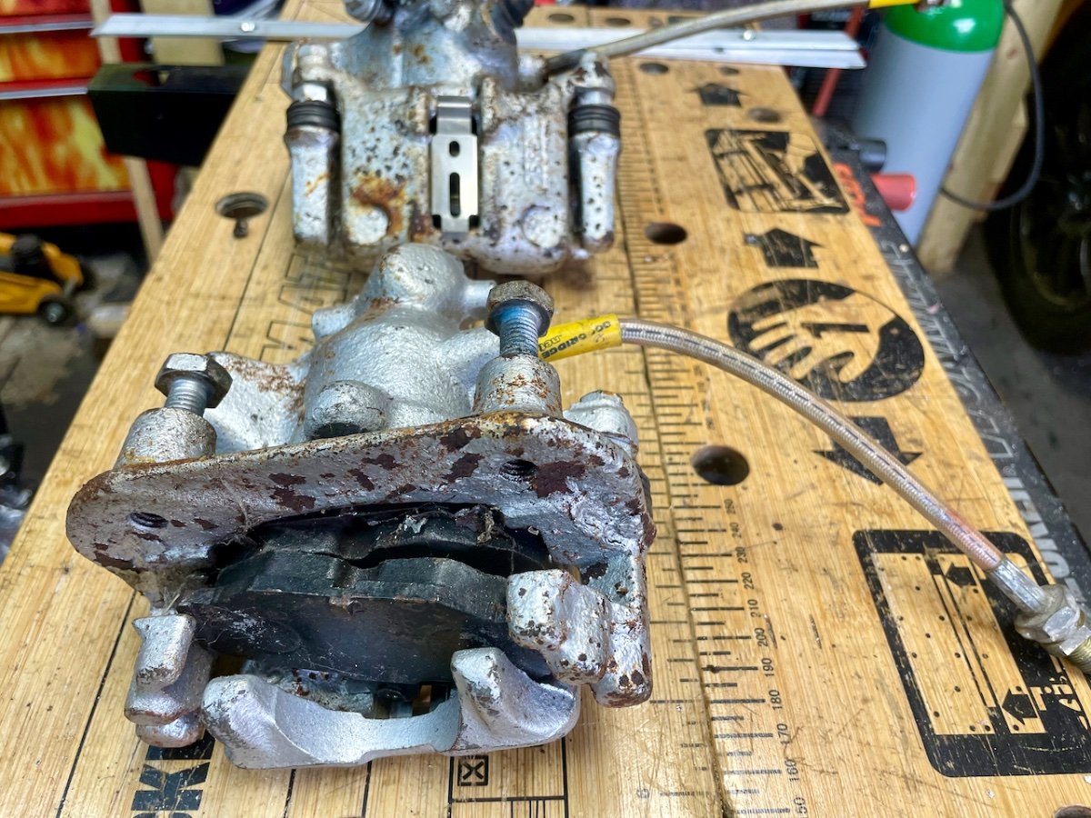

All, continuing my clearcut this year, I have a set of rear calipers. These were on my Zero, covered around 500 miles when replaced them for Hispecs. Been kicking around the garage for the past 6 years or so. Will require new seals etc but otherwise good calipers with new pads. Also includes the googridge hoses.
Yours for £75 plus ship
