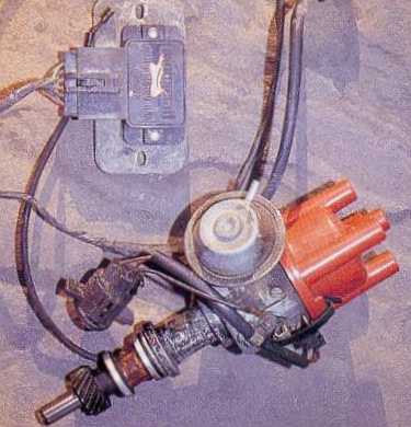

Hi, Anyone know what voltage the coil should be with the ignition system pictured below. Its the one that Jim recommends for carbs. I have it fitted with a 12v coil but the sparks don't seem to be that great.
