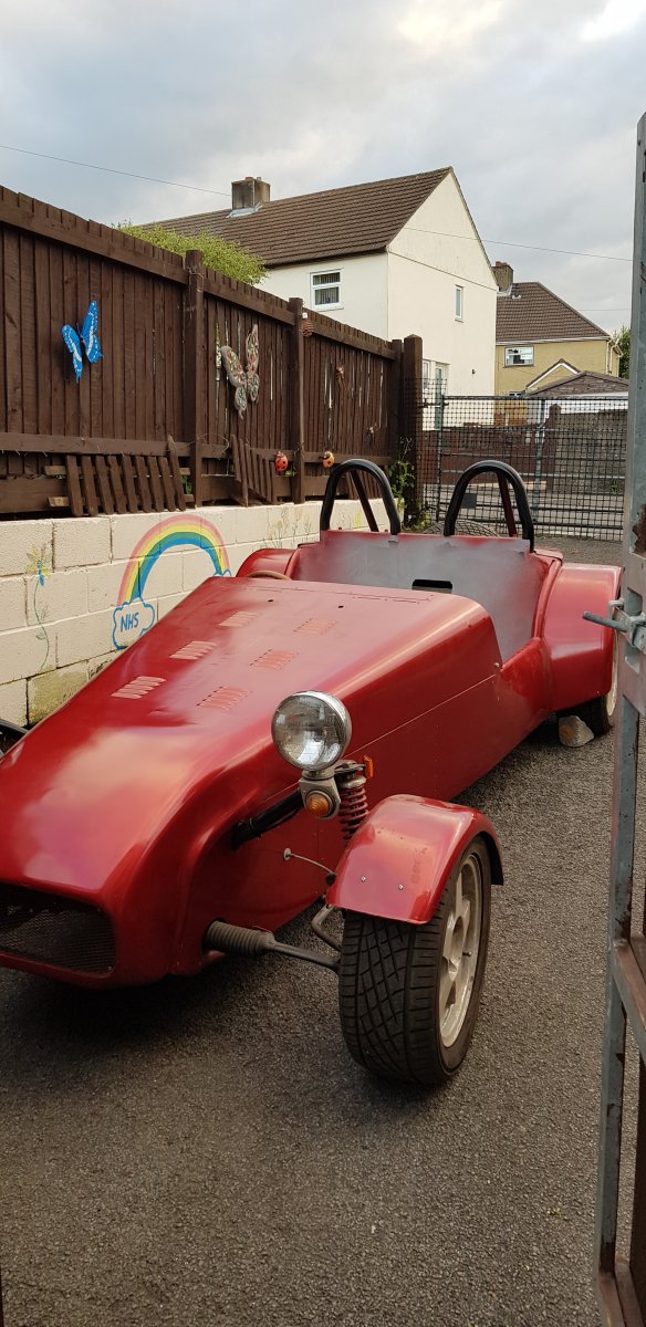

  25. Well she's arrived today so now the fun begins. undo most of what's been done so as to do it at a better standard for IVA, still lots to get and change ie radiator, exhaust, dash, re fix brake pipes and fuel lines. Cant wait to start on her.
