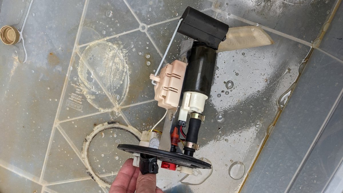

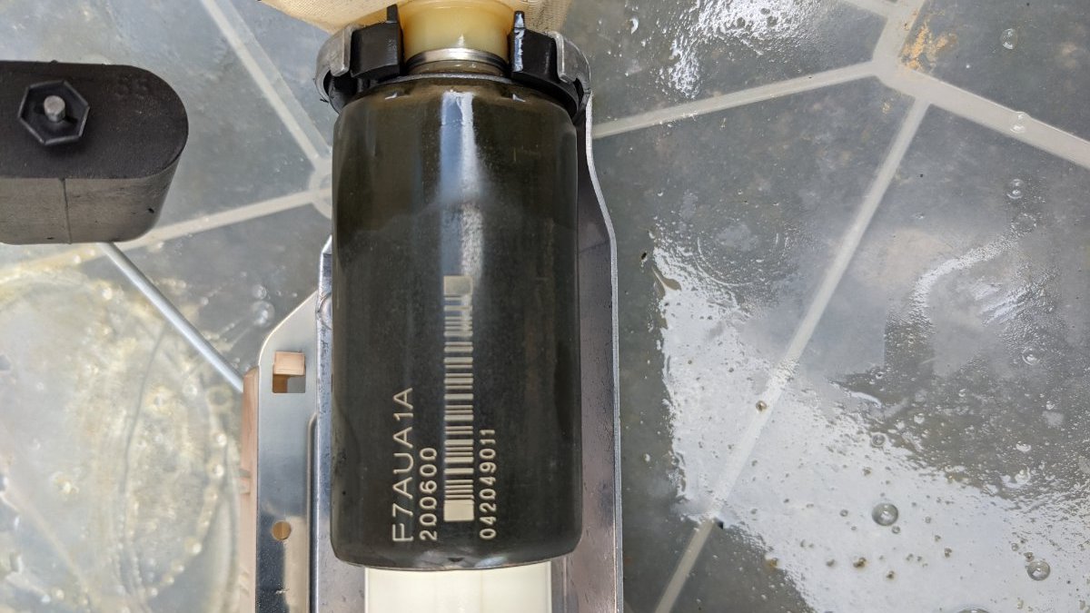

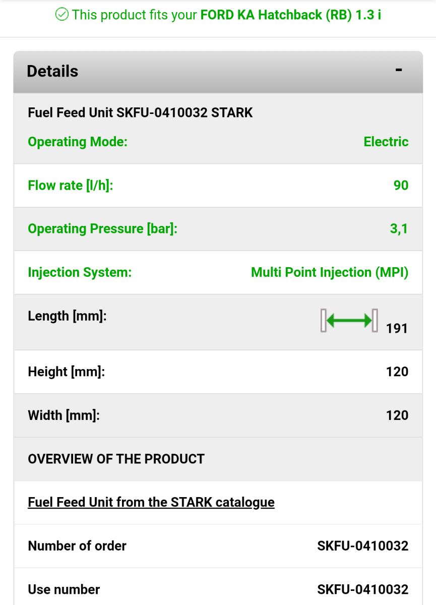

  12. Hi all, first post so apologies if it's been mentioned before. Currently resurrecting my 2005 superspec back to life after being garaged for many years. The fuel pump had seized and blew fuses on any attempt to free it etc. Fitted a replacement today and she fired up first time. If it's any help to fellow owners the details are: Stark SKFU-0410032. Length 191,. Width 120, height 120.
