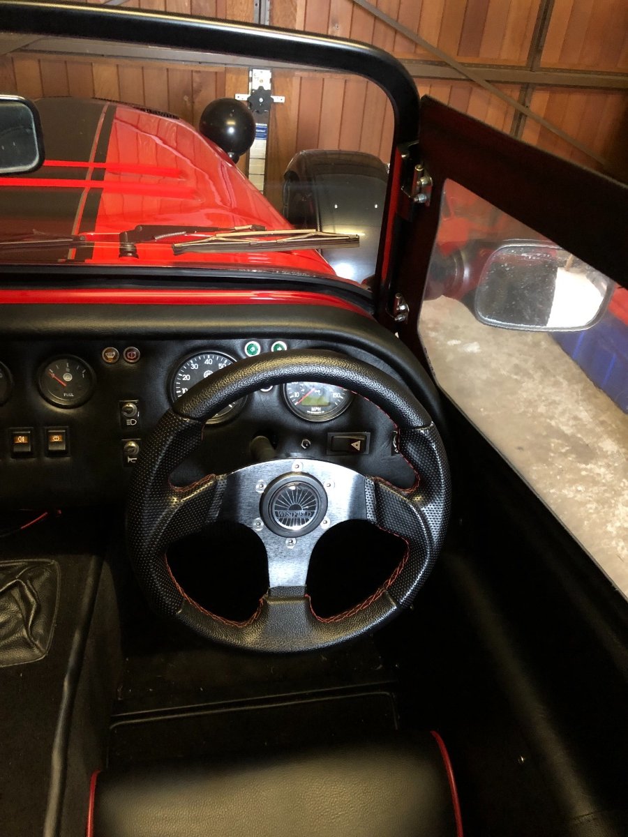

  5. My quick release RaceTech Steering Wheel has decided to stop releasing (either quickly or at all!). The flange is moving freely but the wheel feels like it’s welded to the steering column. Any tips/ tricks based on experience would be very welcome. Apart from anything else it makes getting in and out with the roof and doors on more like an intensive Yoga workout than I’m happy with….
