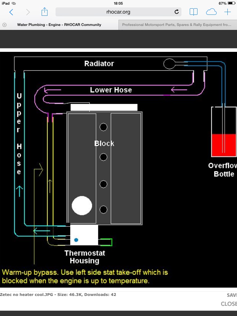

  3. Anyone know the sizes of all the pipes of the above? I had seen a diagram online showing all but can't find it anywhere!

  7. That's the outlet on the left isn't it? If you are stood facing the front of the car. Is it a 19mm?
  8. On second looking a replumb is the only sensible option as the engine would need lifting out for me to be able to remove the thermo housing! The outlet on the right that I have plumbed off at the moment looks smaller?
  9. Brilliant, I had a feeling that might be the case when I looked at the diagram again. Slight re plumb or off with the housing and just drill it. All much of a muchness.

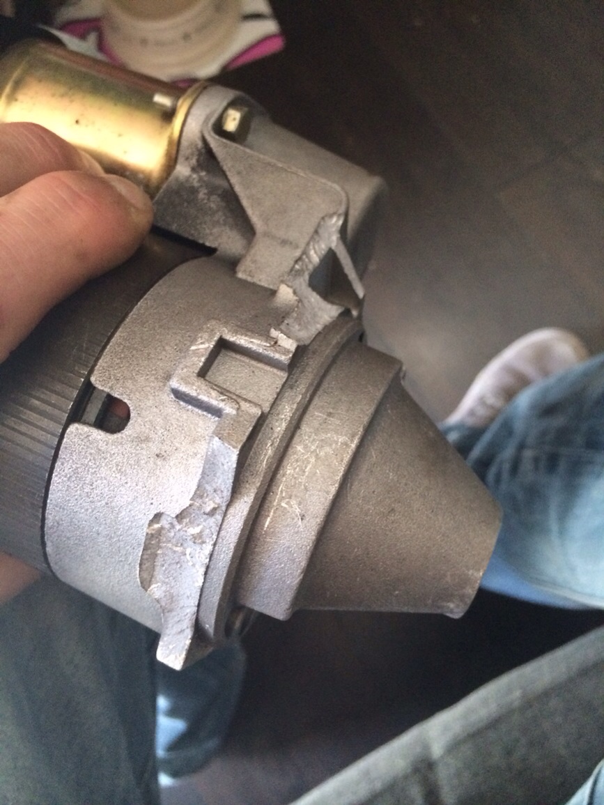

  13. I agree totally, I'm using a 1.8 zetec retroford fly, this was the correct starter and the new one which spins the engine up beautifully is the same fitment. It's unconfirmed but possible internal fault with the old starter. I've broken it down in my head a 100 times, the engine turned on a socket set perfectly and it's run without issue so the fault could have only been with the starter. I thought maybe the clutch had come loose from the flywheel and that was hitting the bellhousing and causing the abrupt clunk and stop but then if that was the case the engine wouldn't have run or turned freely by hand.

  19. We turned the engine and the flywheel was ok, very small metal shards that must have come from the starter sitting in the bottom of the bell housing.. I can't really think what else it could be. As I said it did it a couple of time a week or so ago and then ran pretty ok this weekend.

  24. Hi, as a few of you will know I had a bit of trouble with my starter a couple of weeks back problems seem to have re surfaced. Yesterday me and John (mostly john) got the engine running and ticking over but later on in the day when starting there was a really loud clunking from we think the starter area, I'm fairly sure it's from that area and can only be starter/flywheel related. It did do it a couple of times when I was starting and stoping it on the phone to omex over a week ago and it's since run with no problems so can't be internal. It did seem louder this time though, we turned the engine and all teeth are on the fly, any ideas? Also, the main purpose of my post, what quality starters are you guys using on tour zetec to type 9's and where did you get them? Mine was a £50 eBay job and I fear a case of buy cheap buy twice!
