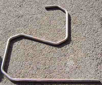

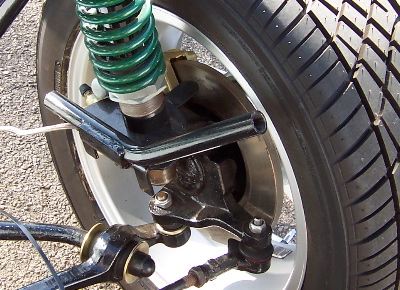

Jamie and Eric - thanks for that! I see how that would create four identical parts. However, I made a template this morning and held it up to the bracket. Which ever way I position it on the front of the bracket, the bit that should be straight across the tyre is angled sharply into the tread. It does work well for the rear of the bracket (with a slight amount of re-bending). I've watched the videos again which show different multibends (about 1hr 5mins into video Z and 2hrs into video S) and Richard produces simple 'L' shaped parts for the front - I can see how they would work but not how to create those from the style of multibend I have. I'm almost certain that there isn't another bit on the videos as I haven't listed it on the index I made.
What possibly isn't helping is that I didn't fit the brackets that came with the kit. They were just solid bar with a plate welded on. I replaced them for a set of the more substantial ones with tabs which are held by the stub axle pinch bolt. The new ones also have provision for putting a small bolt through into the stub axle to stop any possible rotation.

Hi,
I'm a bit confused about how the multibend tube is supposed to make up the cycle wing brackets on a 2B/4. The ZEUS build videos show two different style multibend tubes (one on video Z and another on video S) which are cut up differently. Our multibend tube is different again and we can't find anywhere on the videos which shows how to cut it up! It isn't even easy to see how to make suitable brackets without massively altering the angles of the bends. I've put a picture of our multibend tube and the wing bracket below - if anyone knows where to cut it to make the correct brackets, I'd be very grateful for the information. Another thing is that the multibend tube is the same diameter as the cycle wing bracket tube - I suspect we should have had some larger diameter tube (which would slide over the joints and be bolted right through) included in the kit. Or is that something else that needs to be sourced elsewhere? Many thanks for your help. Best wishes,
Edward

Multibend Tube
in Fitting & bodywork
Hi,
Robin - that would make sense! Funnily enough, that won't be the only part we got from RH which wasn't designed to be used with the rest of the kit
Steve - thanks very much for the offer! We've just about worked out how to cut and re-bend the one we have to produce something reasonable. However, if that doesn't work or we mess it up, we might take you up on that! We'll be tackling that job in the next week so I'll let you know shortly.
