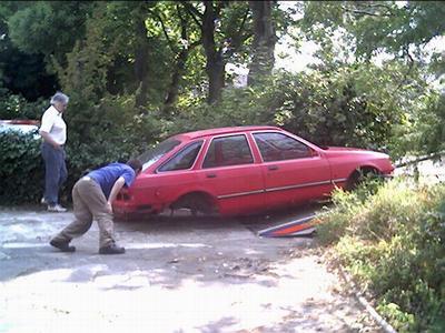

Here's a list of what I got rid of :
Body Shell & Doors - keep all weather strips and seals
Bonnet -keep bonnet catch assembly
Tailgate- keep gas struts
Front Lights & Indicators
Rear Light Clusters -keep rear number plate lights
All Glass
Radiator
Bumpers
Exhaust
Propellor Shaft - KEEP the four bolts from differential flange
Soft Trim - some bits could be useful
Rear Seat
Front seats - if you are not going to use them
I did keep every nut; bolt; fastener; washer & bracket that came off - Just in case :rolleyes:
Here's a picture of the remains going - I have since realised that I should have removed the lock cylinder from the drivers door - later needed for a Fiesta :wub:
