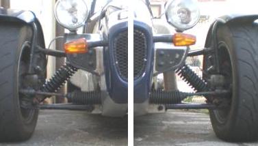

Just viewed the photos. Very nice build. Couple of queries as I assume you have put the pics up for feedback to eliminate possible snags.
Have you fitted stops to limit both ends of the travel on the accelerator pedal?
Wires going into the front indicators at risk of chafing if you haven't put a bit of insulation or shrinkwrap on them where they go through the hollow stud.

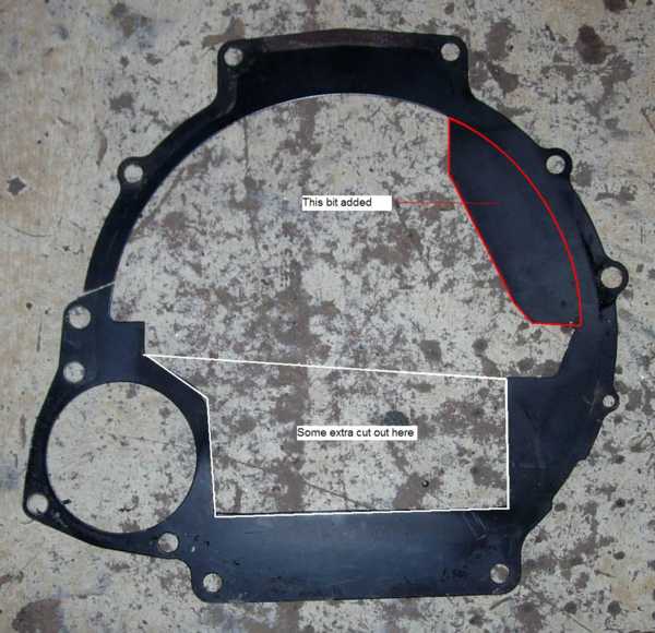

Did you miss out the crud plate between engine and bellhousing?
Have you added a warm up hose between the right lower rear of the block and the water pump? Might alter water flow during warm up in a non beneficial way. i.e. reduce through head flow. May also reduce flow through the rad when hot.
Not clear on front suspension geometry. Have you set camber, castor and toe? Can you do a ground level view pic of wishbones and trackrods looking from directly in front of each side of the suspension. (Only useful after suspension angles have been set to check for rack mounting height for bump steer.)
Alternator mount far too flimsy. It will fall off as soon as you've done 200,000 miles.

Nigel,
Great constructive response, exactly whats needed mate.
Stops on the throttle both ways? I have only the one to stop stretching of the cable / straining of the carb
linkages with full throttle useage.
All wiring is is fully sleeved mate.
Missing crud plate?? No comprende senor?
Hose from the #4 cylinder is something i was advised to do by a friend. He'd been advised to do it by Torquetune.
I looked at it, and using just my own logic, deduced it would help with the notorious "hotspot" associated with the Pinto?
I'm a willing listener mate and treat everyday as a school day, so feel free to educate me. :good:
Camber is at 1 degree negative, Castor is set to maximum i could achieve with the position of the top wishbones and it's been 4 wheel laser tracked. ( A friend has a tyre place, home call out service for a cup of Tetley and a rumage in the wifes.................. biscuit barrel. :rofl:
What do you think i could do with the alternator mount Nigel?? i was hoping it would last? :shok: lovfl.
Cheers buddy, :hi:
Nick.

Crud plate. Looked as if the plate that is sandwiched between bellhousing and back of engine was missing in your photos. Pic below, although its been chopped a bit in the centre to fit a zetec. Not essential but it does stop mud, stones, small children etc getting drawn into the bellhousing. You probably did fit it and I just didn't see it!
Await photos of front suspenders.
