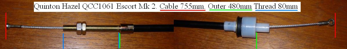

Hello all, where is the best place to get a adjustable clutch cable for a type 9 box. GBS have no stock been waiting ages for one.

Hi Bob i should have put ive got the zero pedals

speedy cables will make you one to your exact spec for about the same cost
This is from quinton hazel. You will see it has the same end as the sierra one for the release arm but a post fixing for the pedal. Bite point is adjusted by the two lock-nuts on the cable outer at the bellhousing end.
Nigel
Thanks Nigel, Good find.
Perfect going to order one better then playing around with a pinch bolt at the pdeal end.
