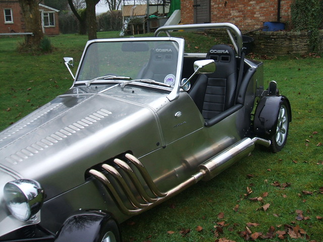

The angle the pipe goes into the box and the swaged pipe were important for the look and a good seal, original Robin Hood 4 branch was modified with a 3" collector.
Made by Paul Gooderham Essex Suffolk boarders
Edited by Snapperpaul

I like the examples so far clean and level with the bottom edge of the car.
Thank you, any more.......

Mark I have the same problem with my pinto,GBS only do the one that comes through the bonnet which I dont like,Ashley exhaust in Walsall will fit one but say between £350-450 thats providing my own silencer.Im with you I like the look of the nice low level fitting as in Snapperpauls picture let me know what you resolve.
Stewart

A very good tidy looking exhaust and probably one of the best I have seen through the bonnet. I am not a fan of the bonnet exit exhaust but a zero with xflow is difficult because the chassis bracing, alternator and starter is all on the same side not much room for a single exit pipe exhaust.
