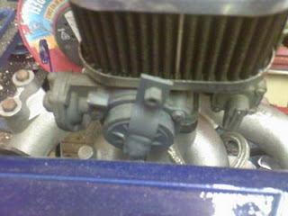

When I was testing the auto choke on the carburettor of the RV I found a crack in the casting which was letting water out in a big way .
So after a bit of fabricating i made up a manual choke set up using some of the parts from the auto choke.
The set up is working well on the bench but will pass judgement when the engine is up and running .
