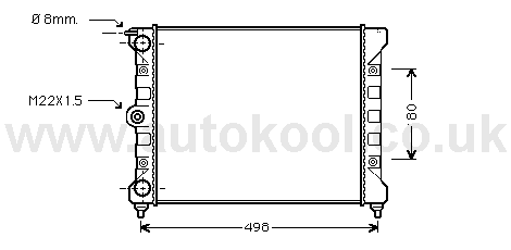

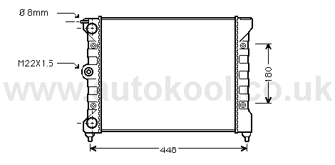

Standard westie rad is VW polo 1.0/1.3 from 90-94. Core is 380-320-34. Side tanks and left top and bottom hoses. Another they use is for same car and years but core 430-320-34mm. Same layout. Part numbers at Autocool, http://www.discount-cooling.co.uk/ are VWA2039 and VW2038. They sometimes also use VW2028 from a golf. Depends what fits your car. Pictures are 'borrowed' from their website.
Nigel
