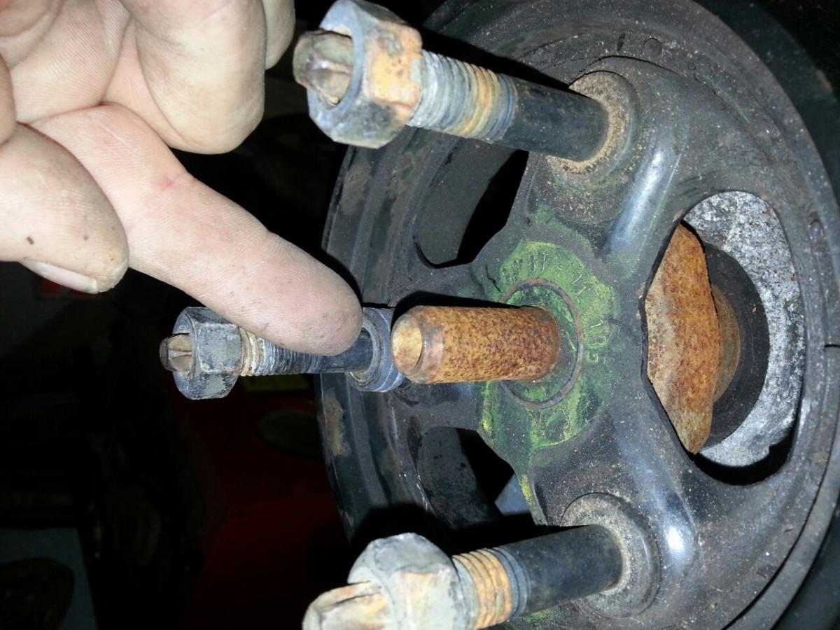

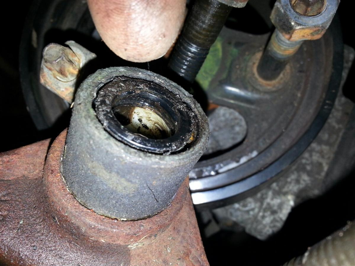

I have just found a source of these I had to get one for myself but there was a minimum order number so I have some spare, £20 including postage 2nd class royal mail UK only.
pm me if your interested.post-10857-0-43987000-1453835703_thumb.jpgpost-10857-0-57363300-1453835713_thumb.jpgpost-10857-0-01319400-1453835726_thumb.jpg

and because of the way the prop engages with the gearbox flange the prop cannot move out of alinement see photos

I'm sorry but you are wrong just take a look at the above photos of the prop and gearbox the prop would not disengage with the gearbox.
