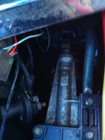

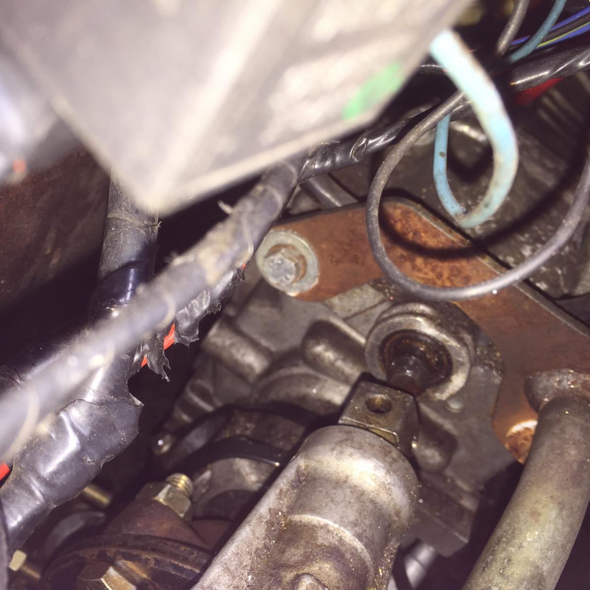

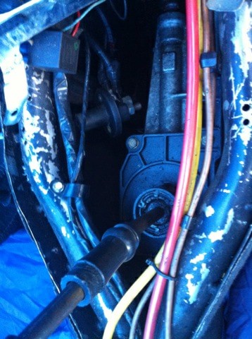

Hi guys. Thanks for your help so far (and patience). These are a few pics of the gearbox and shifter. Can you identify if anything is missing
Thank you
Looks like the pin has broken on the linkage and is still in the shaft near the gearbox that would need driving out and new one fitting
