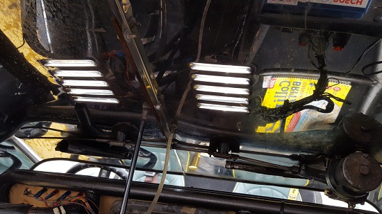

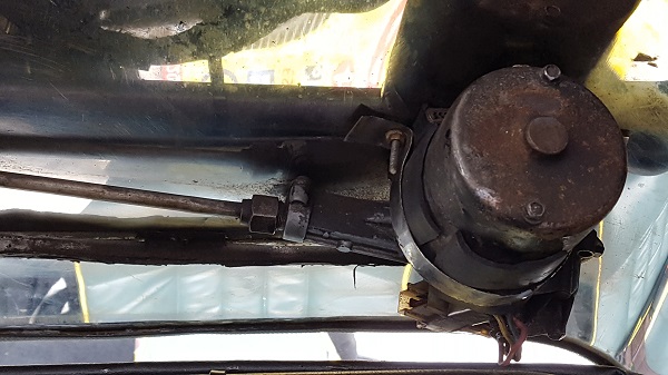

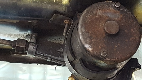

Does anyone recognize the wiper motor in the pictures, its working intermittently, I will take it off strip it and check it out but, just in case I need to replace it, any ideas?

Just trolled through Fleebay and I may have found something. It may have come from a mini, is this common on the 2B` s?
..eBay item number:
173177884934
the build videos told you to cut down the sierra original wiper motor, but mini was easier
cbs do the spares
Biggest problem is probably the self-park switch ( white plastic on side c/w 3 wires ) they can fail due to water ingress.
I managed to pick up just the plastic bit at Stoneleigh at one of the stalls in the side hall just a couple of £ as I remember.
