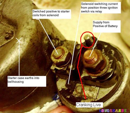

New plugs, HT Leads, Distributor Cap, Rotor Arm, and coil are nice but probably unnecessary although a new coil won't go amiss just as a check in case the old one was failing. You were pretty sure there was no ballast resistor knocking coil supply voltage down to 9v and have checked the coil supply is indeed 12v? Odd that your starter solenoid has extra LT wiring which would usually be associated with a ballasted coil supply/9v coil and giving a cranking supply to the coil of 12v. Pic below.
