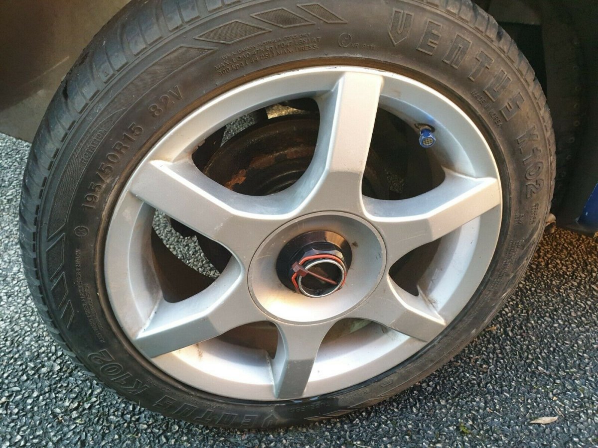

I have not before seen the type of wheels fitted, centre lock with a locking pin, photo attached.

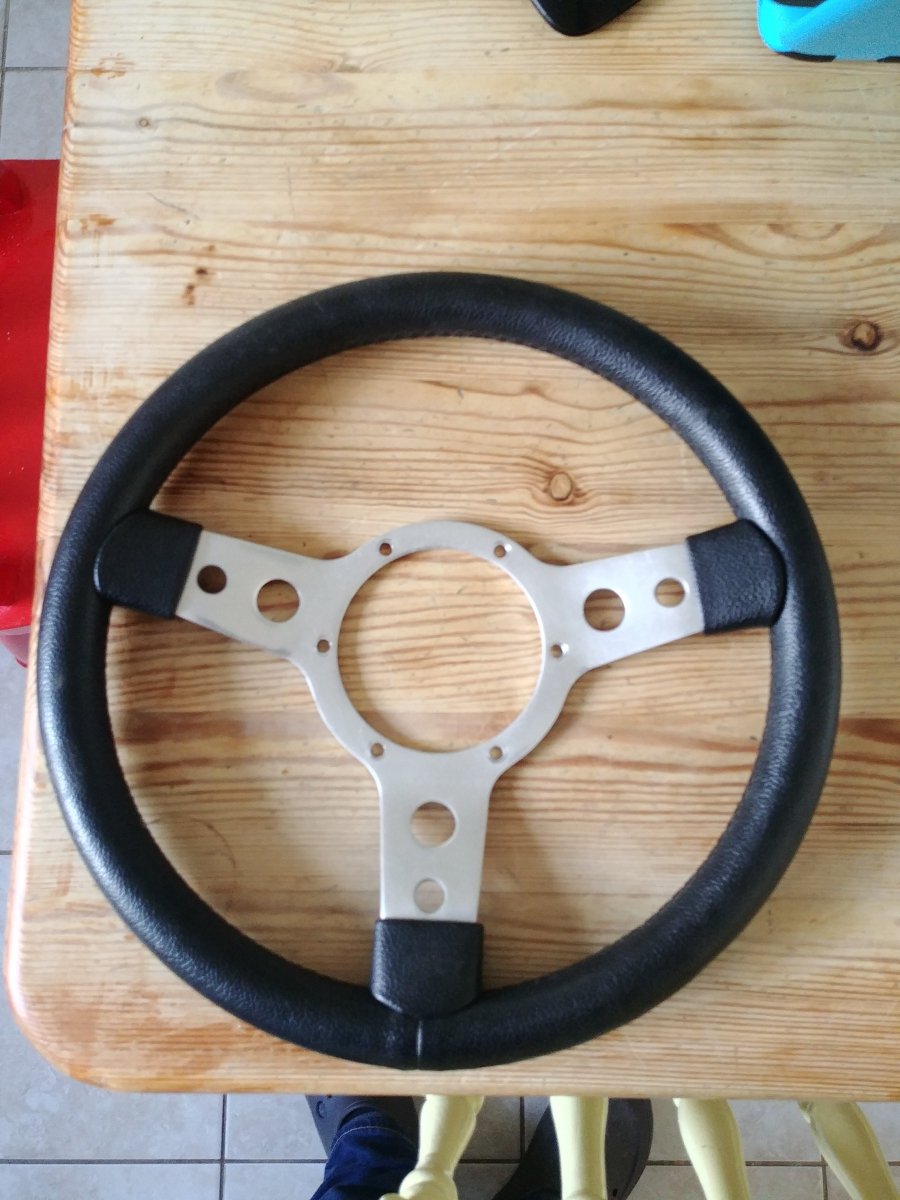

I have a 13" Mountany, I live about 10 miles from Exeter so can drop it round for you to try.  You may find a 14" or 15" will be to big and the wheel will be to close to your legs
I have the boss for it as well somewhere. Other pic shows it on the car before I changed

Neat way of holding in the centrecap but presumably the standard studs and bolts are under it. Have you examined a wheel to check that the offset is correct (my original steel wheels were ET41) and they have a ford centre bore or suitable hubcentric spacers?
When driving is the steering effort acceptable? Does the steering self centre at all/slightly/strongly if you let go of the wheel after a turn? These points are more to do with suspension set-up that can have an effect on steering effort.

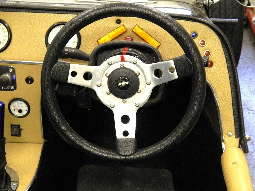

Hi Barry, thanks for the offer but another member, Graeme, has given me a 13" which is a good fit.

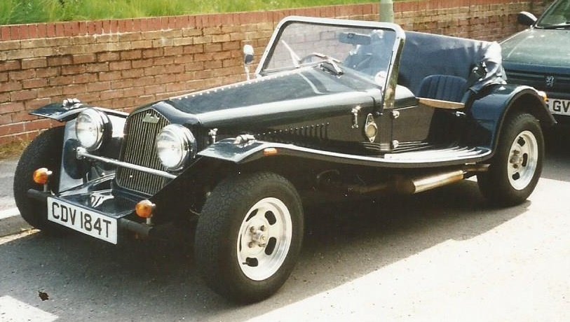

I had to make it detachable because the original builder set the steering column too high and doesn't  allow the 'alligator' bonnet to open fully.
I have also fitted extra large indicator repeaters because some years ago, when I had a Marlin, I left the indicator on & a van pulled out of a side turning in front of me.
I managed to miss the van but ended up upside down in a ditch, the Marlin rollbar- windscreen saved me from being squashed flat.
