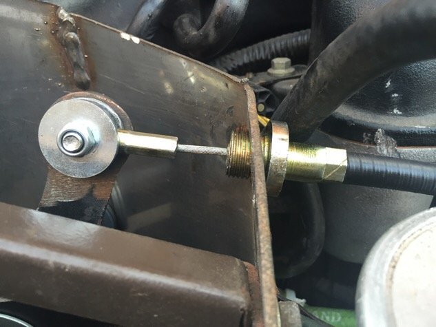

Hi Dean, where did your cable break? When mine went a couple of years ago it was where the inner cable enters the pedal box, as it’s at an angle to the outer cable where it exits the box and frays.
I made an approx 30 deg angled spacer to hold the ferrule of the outer cable at the right angle to the pedal box wall. The clutch cable now goes downward toward the steering column rather than straight out. Sorry I haven’t got a picture of the spacer itself but this photo shows the straight line path it makes the cable go.
I lubricated the inner cable with bike chain ptfe spray when I reassembled it, and also put some exhaust wrap around the cable where it goes under the exhaust headers to prevent it overheating and drying out. I’ve not had any problems with the clutch cable since then.

Well I have replaced the new cable (what a farce that is). On the plus side I made a new bracket and put some PTFE spray in and what a difference it makes.
The clutch is so much lighter as I have put the mounting point closer to the driver exposing more cable in the pedal box and making it straighter. I could only do that as the top of the clutch pedal is slightly bent allowing the cable to pass straight by it.
