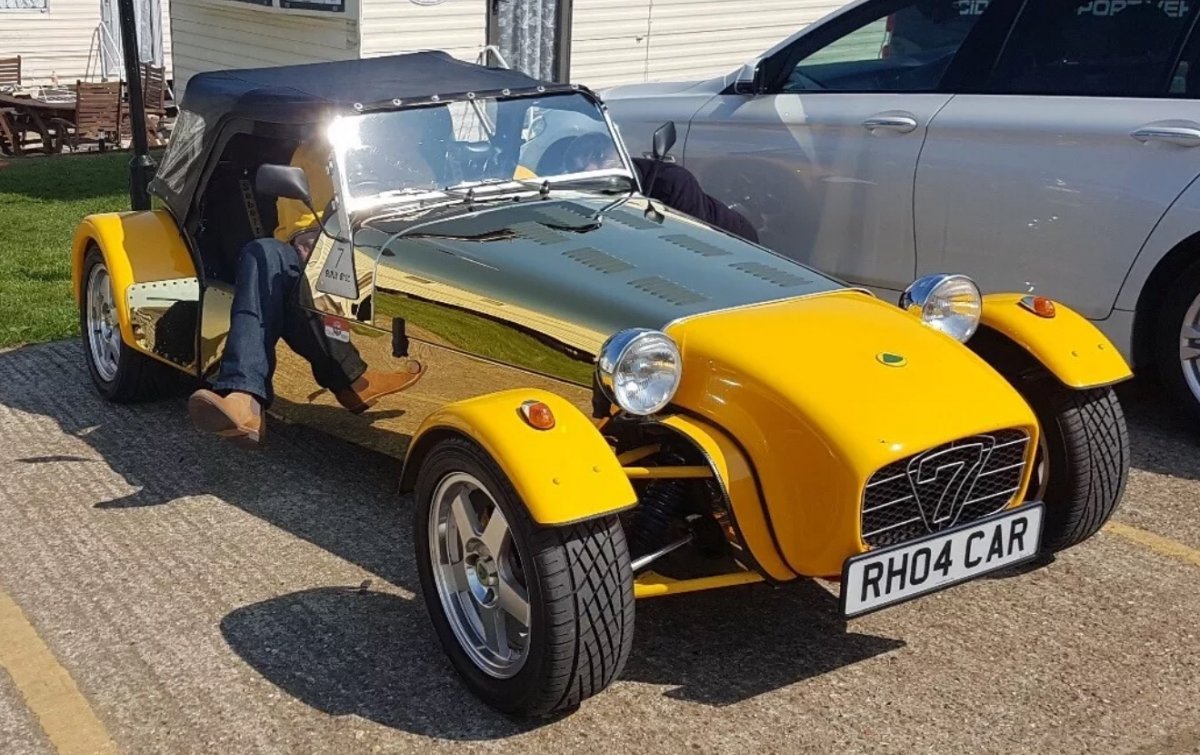

I’m new on here and only just purchased my first kit car.... Robin Hood Super spec I purchased it with the plate RH04 CAR... very cool... just a few bits to sort like the very heavy clutch and some poor wireing modifications where the stereo was fitted but I guess that’s now for me to rectify... also the exhaust is REALLY noisy in fact it’s hard to talk to the person next to you is that normal or can it be muffled a bit....?

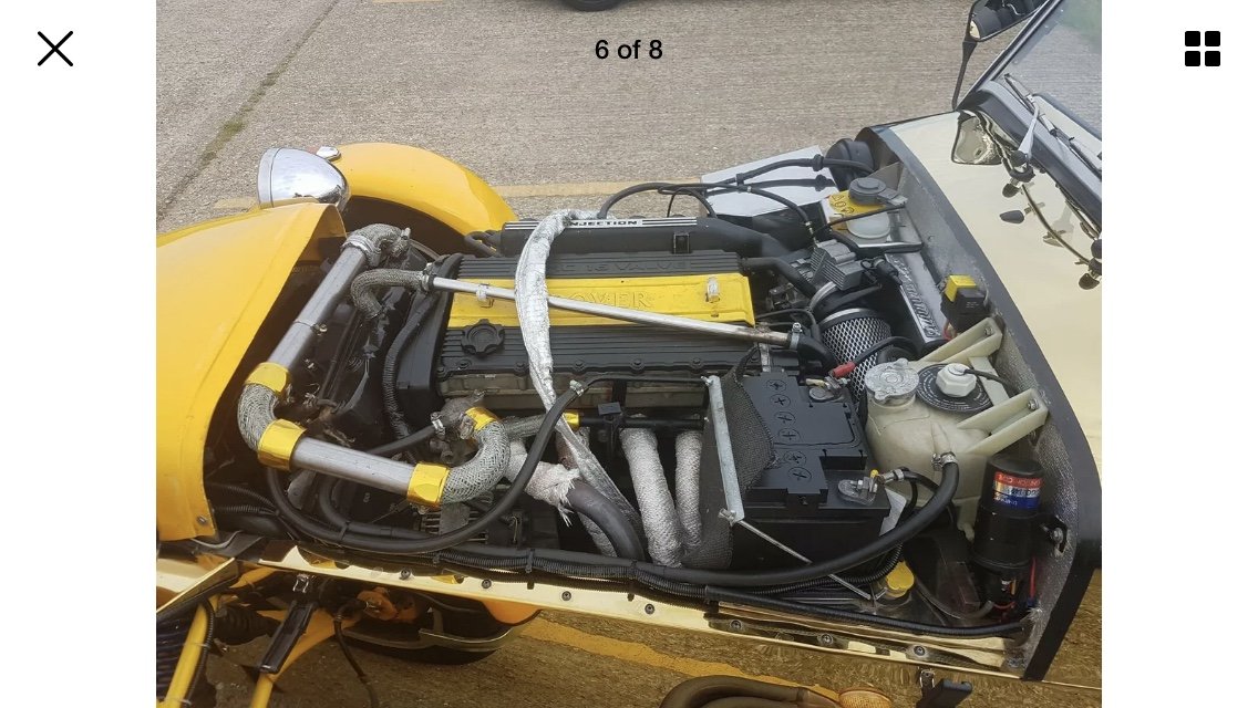

Looking at the photo of your engine bay, is that the clutch cable in a silver sleeve going across the top of the engine? If so, it's too short and will make the entry points to the pedal box and the engine plate ahead of the clutch lever, very sharp. That can't be helping your heavy clutch.  You need to make the cable run into the entry and exit points as straight as possible, which means looping it around the front of the engine. And as Al says, make sure you have a linkage that allows a straight run onto the clutch pedal as that's where they normally fray and snap.
Also I see you have the original RH coolant plumbing with the small loop return pipe (or heater loop if you have one) going across the top of the engine into the centre of the radiator. We found this leads to slow engine warmup so I did a redesign as per the attached diagram which is more like the original Rover system. I now get a 7-10 minute warm up and no problems with overheating.
Yes your correct that is the clutch cable, it’s obviously been changed before and for some reason they have fitted a small cable and put some heat protective cover on it, it’s so short the cable cuts across and over the engine.... it doesn’t look great either, it’s very hard to push down and very short, so pulling away in traffic is more like having a switch for a clutch either on or off......, your diagram is brilliant and very useful,... thank you I will change the cooling pipe.

Yes, that looks fine.   As Andy said, it's long enough to go round the front of the engine.   It's important to avoid the exhaust manifold when it is installed, I use a couple of cable ties to keep it away from the pipes.
