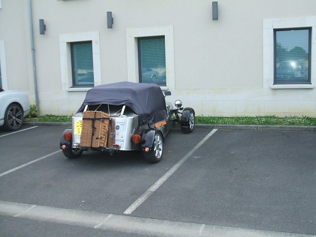

2B with stainless chassis & stainless bodywork,front wish-bones; no fantastic plastic on our car. 54,00 miles so far -- all over GB plus France, Spain & Italy ( Germany by mistake )
Our car is for cruising , no great power as have the stock 1800 CVH engine converted to run on injection from an XR3i  & used pretty much all we could from the Sierra donor including the heater & sun-visors.
Next to no problems in 8 years, sails through MOT every year & minimal maintenance.   No bother seen with the stainless chassis, believe its 304 grade but could be wrong.
Pictures from France this year.
