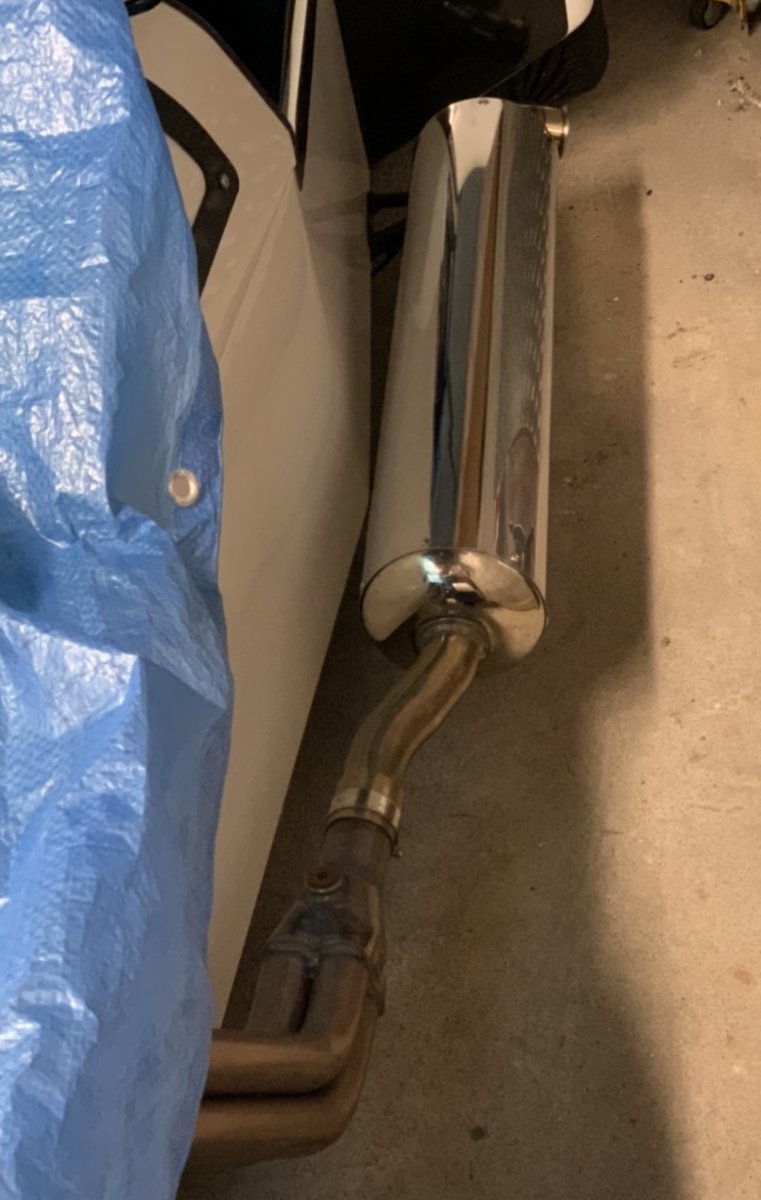

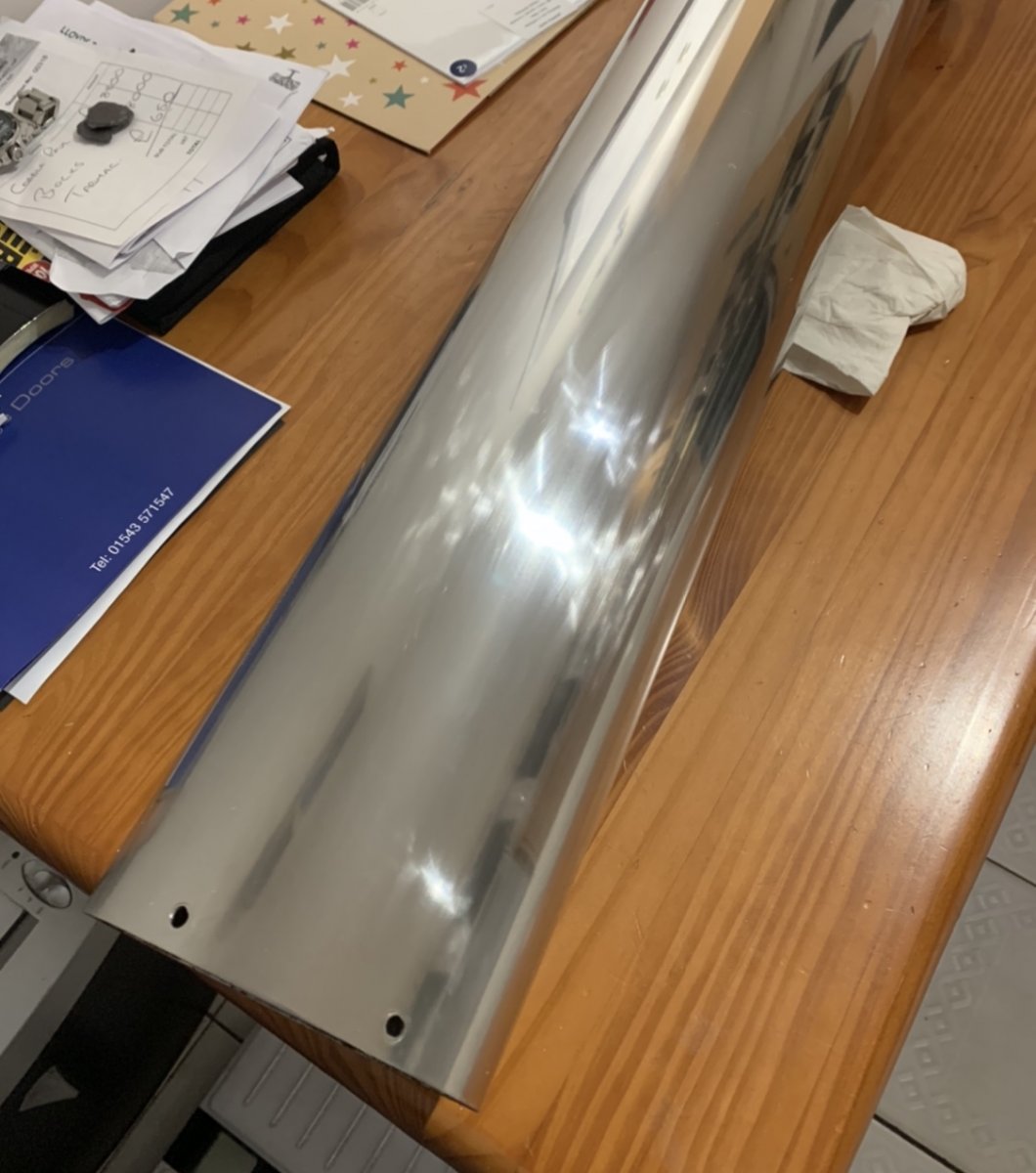

I had a huge dent in my exhaust, I’m sure some of you will have seen it at the recent GBS open day. Steve at GBS was extremely helpful in offering a solution, a friend offered to sort it for me tho. He was a sheet metal worker and beat it back into round then polished it back up. Well chuffed. Did the extra rivet mod whilst it was off the car to stop the rattle.
Before, during and after pictures:

Yeah I watched him do it, it took hours. He said it’s the hardest stainless he has ever seen. Work hardened I guess being hot and cold all the time. Vert impressive anyway.

It was a skill to watch, the dent didn’t simply push out from behind, it was very solid and took some extreme heavy hitting with a 2lb lump hammer believe it or not, all be it one with a mirror polished face. We didn’t have an anvil so makeshift tube in vice was used, then on to smaller hammers and dollies before filing, sanding and polishing.
