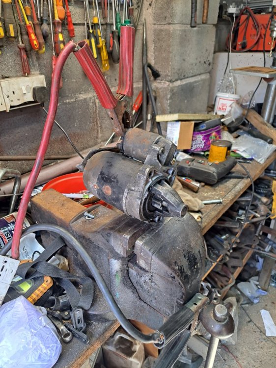

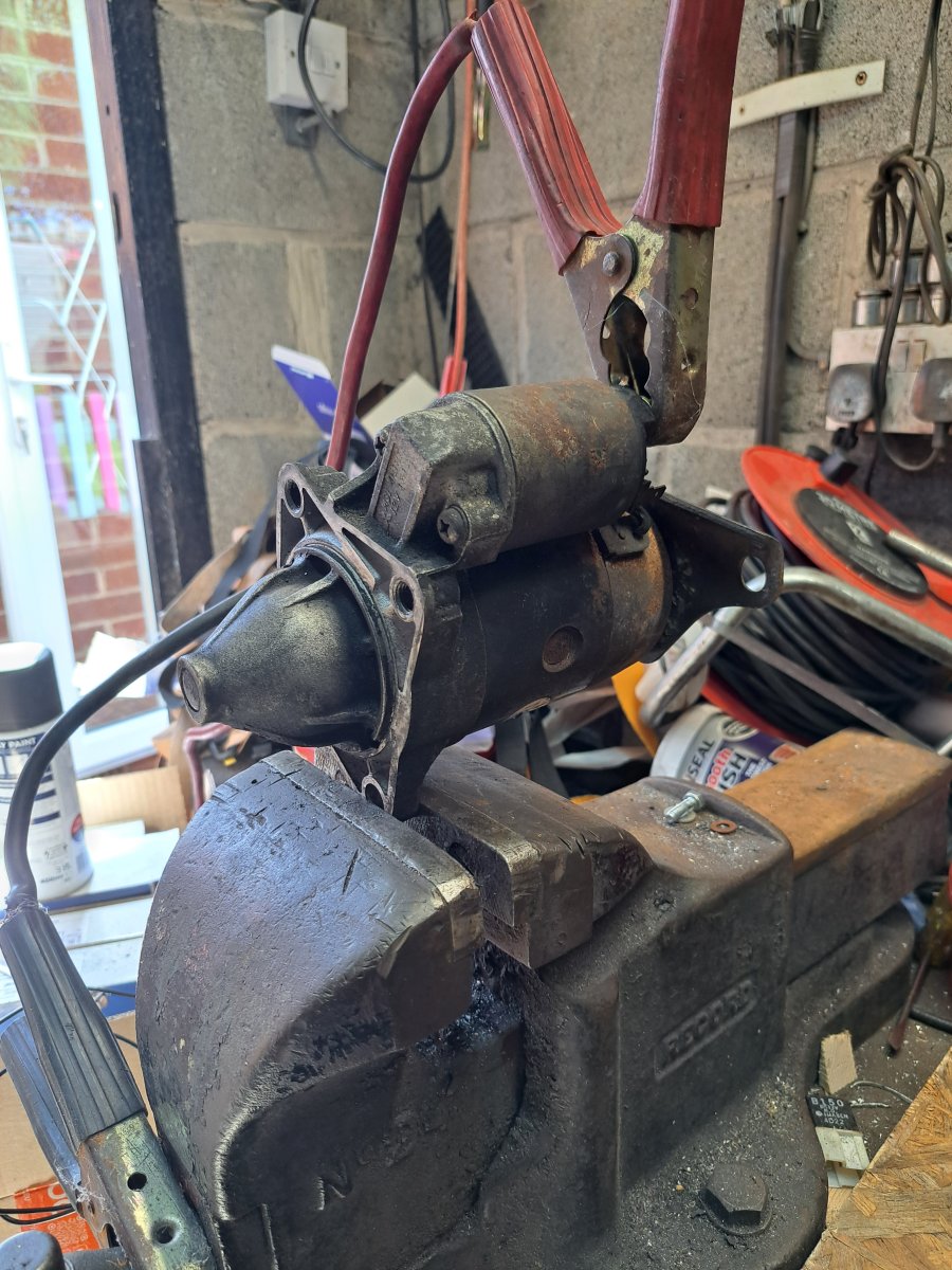

  9. Sorry I don't think that is the right one so be careful, you could order it, take yours with you & get a refund if it's not. But it is a commonish starter motor by the looks of it, MGF/TF, Rover 200/400 if you use this advert https://www.ebay.co.uk/itm/318418855076 or https://www.ebay.co.uk/itm/257562095811 put in the Reg No it brings up https://www.eurocarparts.com/p/lucas-starter-motor-402751001 Looked in the workshop & I have 3 starter motors, 2 which I'm sure are MX5 ones & 1 other which I have no clue as to what it is but logically it 'should' be a K series one, all my previous kits have been either A series, K series or MX5. Here are a couple of pictures & a link to a video on Youtube to save the site bandwidth https://youtube.com/shorts/yzCNJQpKlBg?feature=share If you want it it's yours but I'd prefer collection due to weight, located just North of Worksop it's whether it's worth the journey currently with the price of fuel, unless we can get a club train going, but I've no idea which members are between us. Another thought is I'm going down to London(ish) the first week in August I could meet you somewhere near the Black Cat roundabout (or area)
