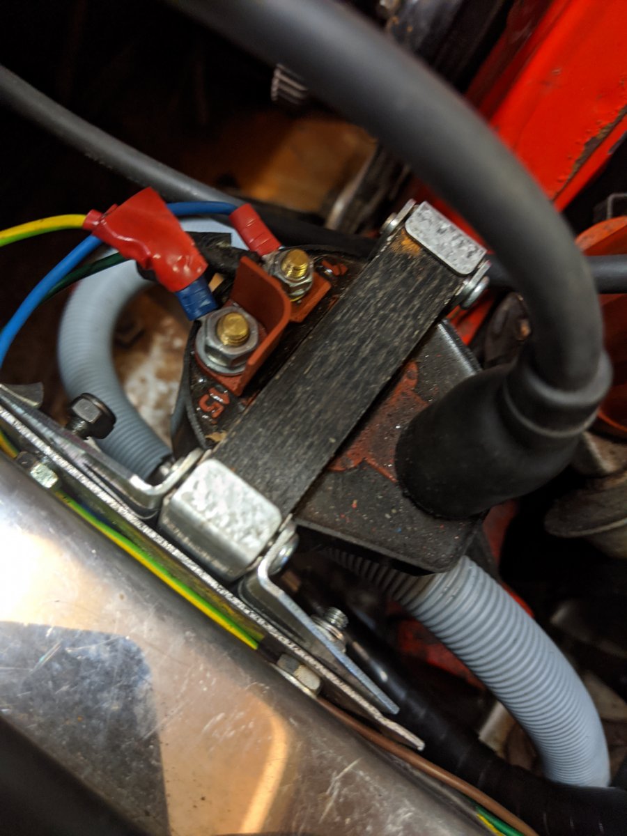

Also the coil has been replace with a modern one as the old one was obsolete (see pic)  It is 12 a volt one.

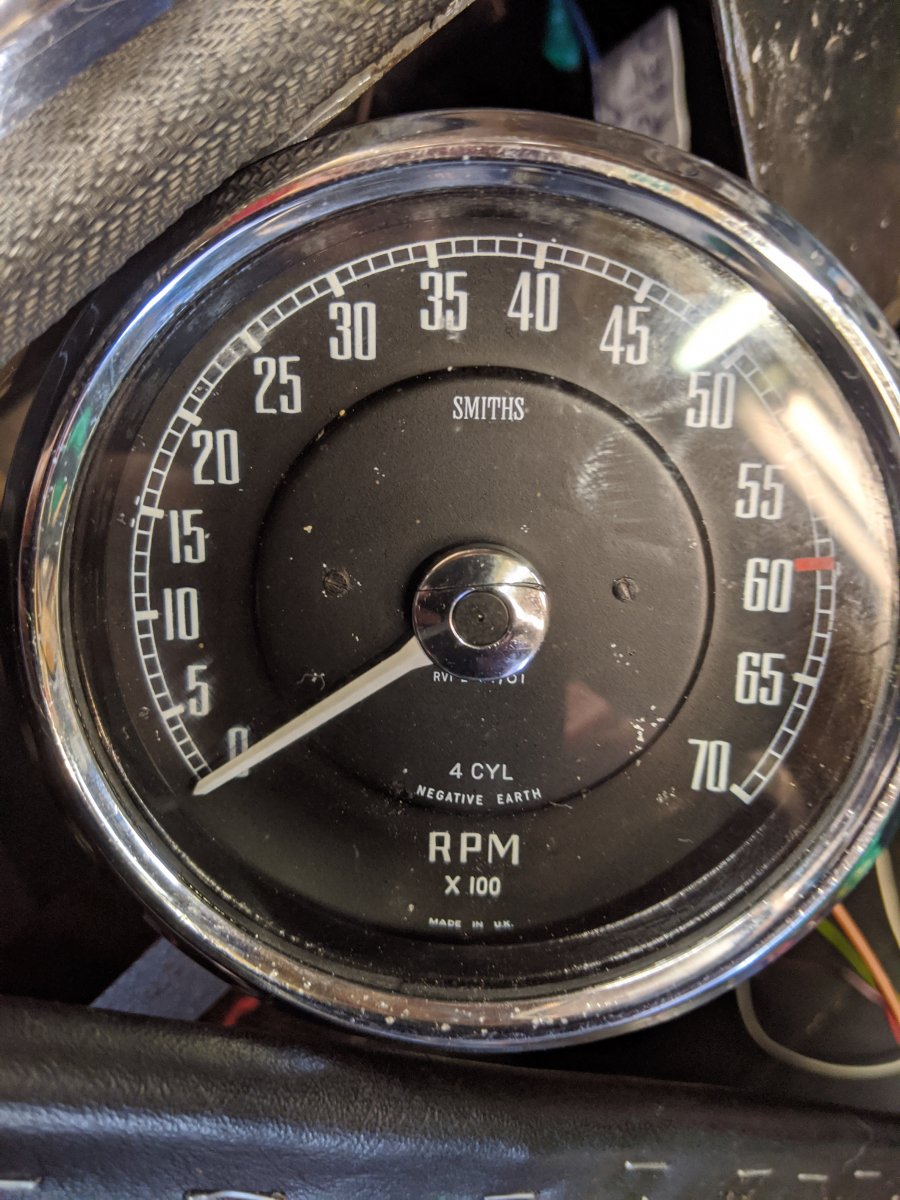

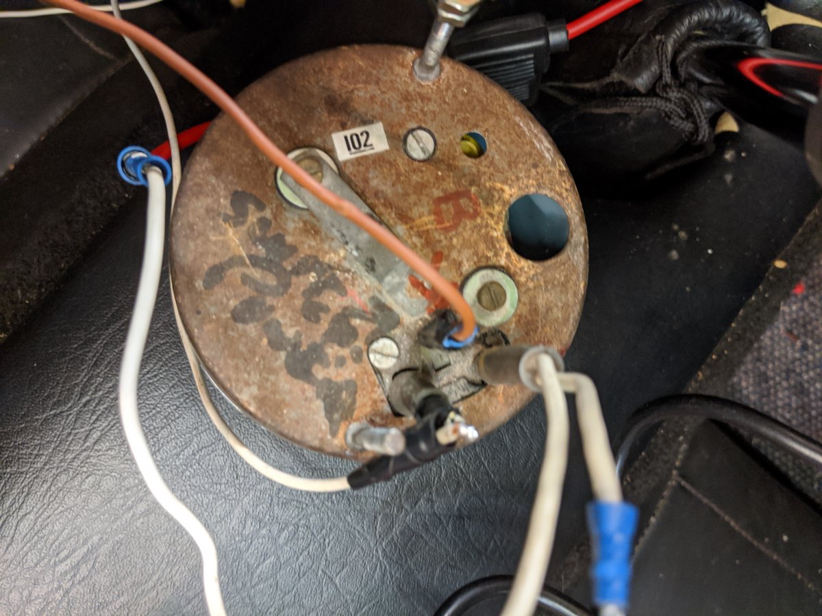

I have attached a picture of the tach, front and rear.  Could someone advise me which connection is which/  I am pulling my hair out here.

That's right, your tacho will sense the voltage change at the coil neg, as the points open and close.This earlier tacho (it looks like "RVI" hiding underneath the tacho needle in the photo) uses the current in the ignition LT circuit to drive it.

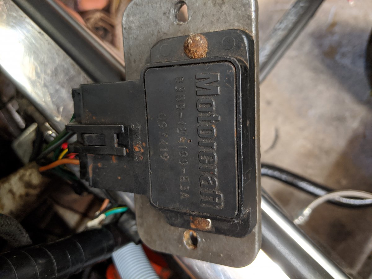

As  i said on the previous post, I think it has electronic ignition.  I have attached a picture of the 'Module'
Is that classed as eletronic ignition? and does that mean my tacho is not going to work?

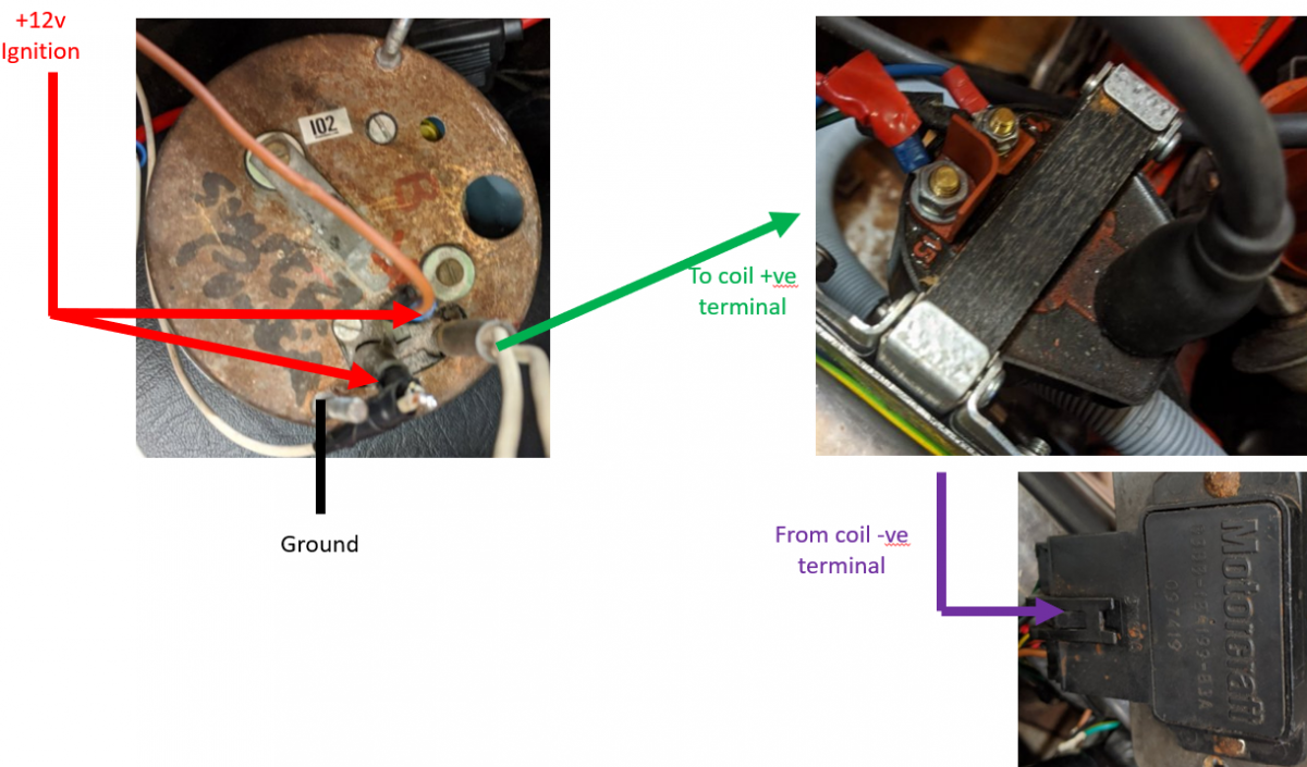

If the +12v ignition feed that goes to your coil is fed through the tacho as per the circuit diagram (on page 14), then it should still work. The electronic ignition module, that you have shown, replaces the points, but you still have a coil with LT wiring.

I have not been wiring to the + terminal on the coil.
Be sure the existing wire feeding +12v to the + teminal on the coil is removed (else no current will flow through the tacho and it will show no reading). The only wire connecting to the + coil terminal should be the one from the tacho (the green wire in my picture in the post above). And don't forget to ground the case of the tacho (the black wire in the picture).

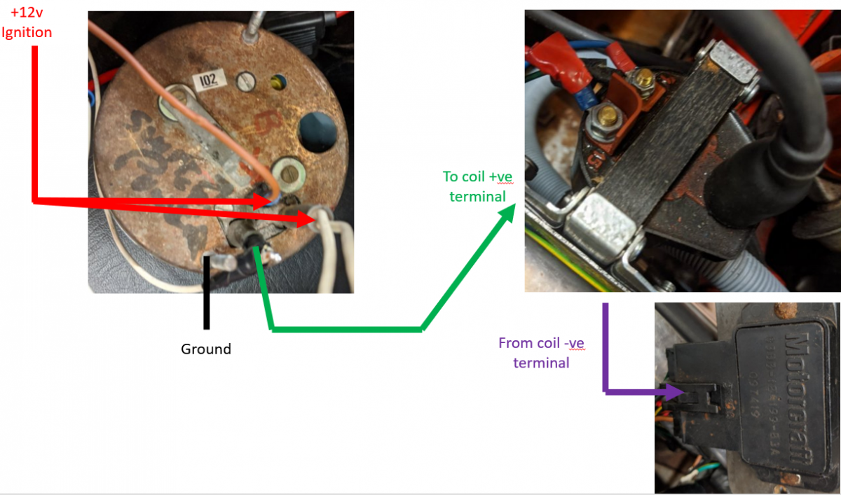

Then, if your engine runs but the tacho still doesn't show a reading, swap the two wires on the bullet connectors, so the circuit is then like this:

I did this as you said by linking 1 and three, and 2 and three,  You said the coil should go to the electronic module, but as there babout eight wires i m not sure which wire to attqch it to.
Will that cause the needle to bounce?  And werdly when i short out  the two feeds that brake lights come on ?????

Your circuit looks ok for a points ignition system.  If you're using the motorcraft module then it needs to be connected.
Here's my circuit when I ran with the module, before changing to Megajolt:
6 wires to the module:
B = Black to +12v ignition
N = Brown to ground
BR = Black/Red to Inductive trigger
GY = Green/Yellow to Inductive trigger
BG = Black/Green to cranking signal
G = Green to coil neg
My rev counter is not a Smith's RVI, so is wired differently to yours, but the module wire functions are the same.
Your brake lights coming on??? Not sure about that, but I think you need to double check all the wires you are using really are what you think they are.
