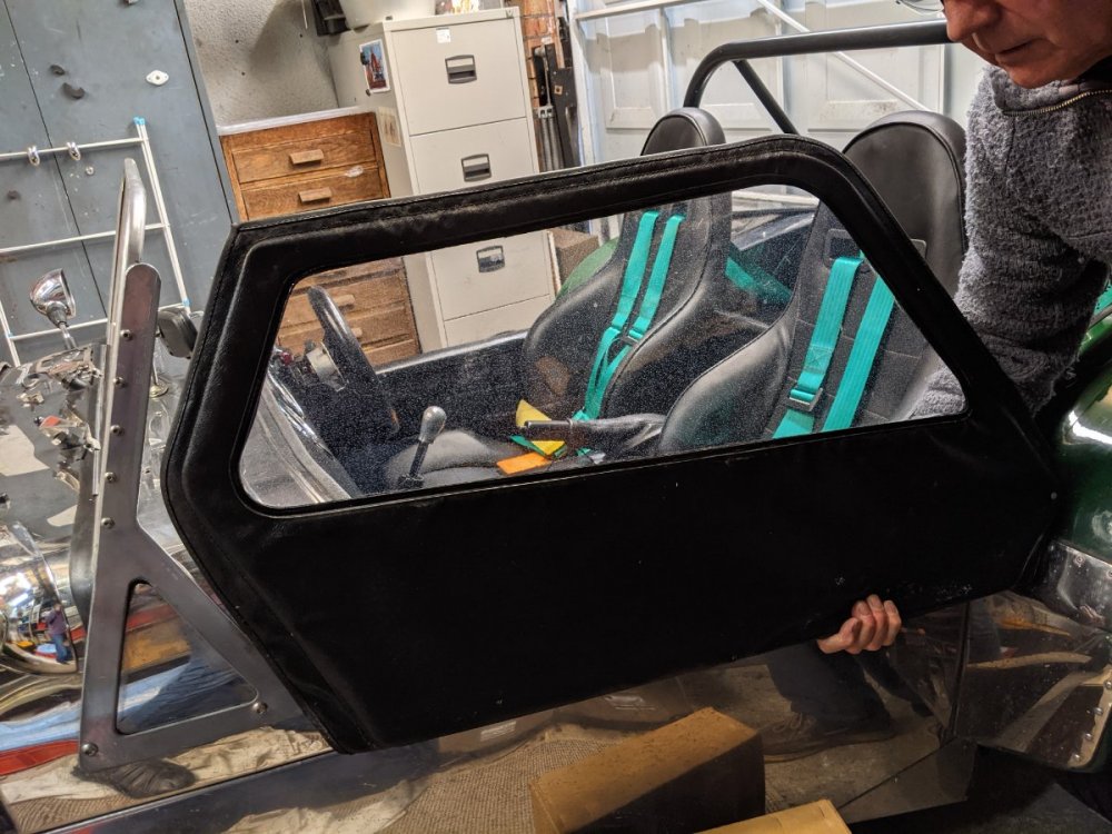

  16. Thank you everyone. I see now I had the door the wrong ay round, but as you see by the next picture the angle still is not right. Looking at the latest comments it seems the angle sould be 65 - 70 degrees. Anyone know were I can get windscreen brakets the correct angle for an Exmo?
