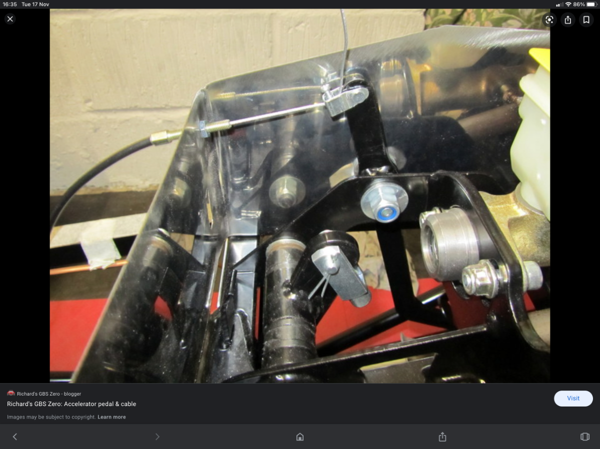

The metal bracket fits on the end of the accelerator pedal pivot.
it stops the pedal box pivoting as the clutch pedal is pressed.
the ends of them are cut to fit the square tube chassis

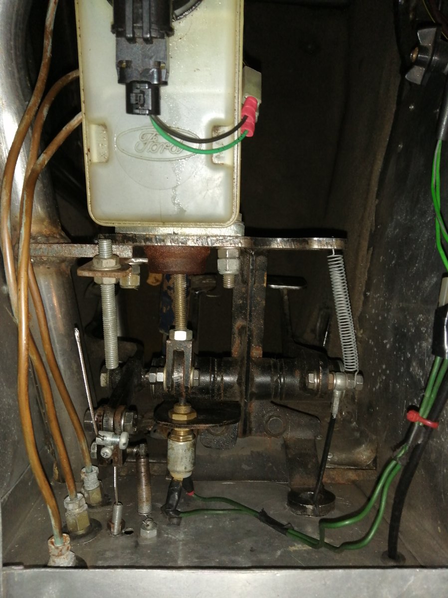

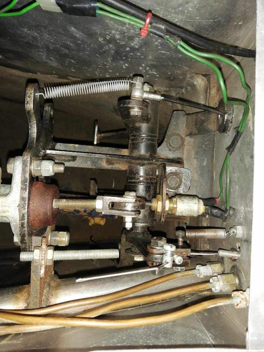

Any good? The throttle cut and shut is behind the steering column, mine is cut by the slight kink in the original pedal making it a bit more kinky 🤪.
1.thumb.jpg.d5c7f339e1bd7ea14e59394dbcaa6c88.jpg3.thumb.jpg.4bf2c613a8680ec3b5079cde41228a03.jpg4.thumb.jpg.3cbac4326d1719fd92c7f07f402c050c.jpg
