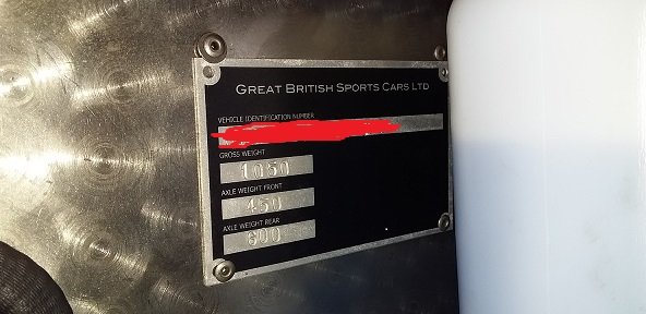

Details as below.
Gross Weight
1050
Axle Weight Front
450
Axle Weight Rear
600
Edited by maca
Details added
The weights on the plate are not the actual weight of the car but the maximum allowable weight when fully loaded with driver passenger luggage etc.
So weighing your car will not help, as the suspension is sierra based for a 2B any weight up to what ford allowed is reasonable with some consideration for the springs you have fitted.
The VIN should be unique (and not the doners) and can be issued by DLVA or you could use your name and date of significant event padde out to the required length with random numbers as a lot of people have done.

17 minutes ago, maca said:
Details as below.
Gross Weight
1050
Axle Weight Front
450
Axle Weight Rear
600
Thank you very much! This is perfect!
Guest PJLewis
Thank you Ian, spot on. Completely cleared that up for me, I was very much in the dark on this!
You don't need the weights on the plate - just VIN number and manufacturer. In fact, it is an IVA fail if you put the weight on and it is too low, so better not to put it on at all.
Ref. to IVA section 18 -Statutory Plates  Also Note 2
The details I stamped on my plate where correct for a 2B
I did not read  Note 2 when I prepaired my car for IVA and passed 1st time.
