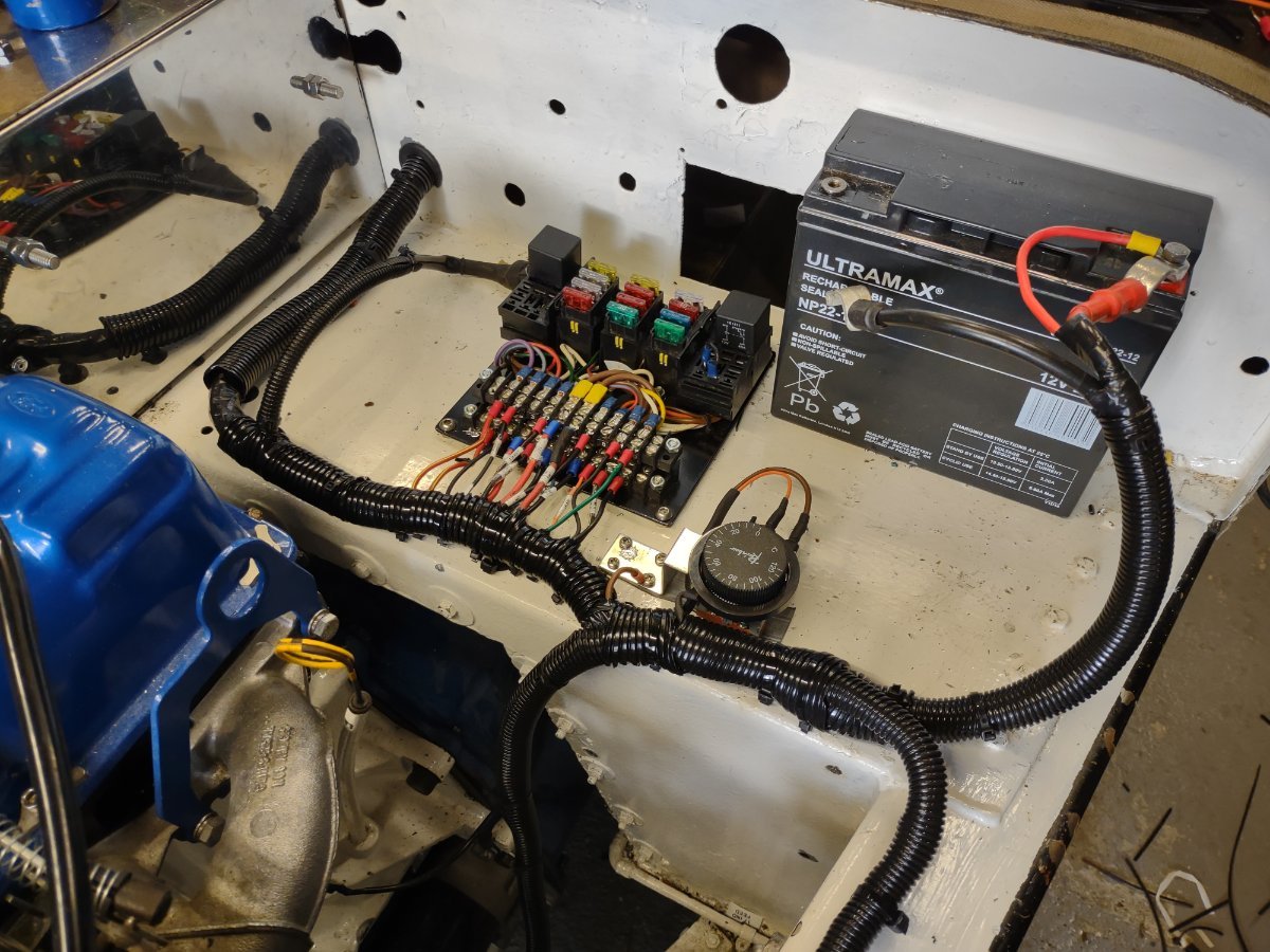

So there is an adjustable that CBS sell, have been chatting to them. At the top seems to be consensus (still think it should be at the bottom, but I'll go with the top so I can say "told you so" whilst I'm waiting for the AA😂), and there is a probe that looks like it can just be tucked into the duct at the union with the rad.
I've got a relay on the FB, and have already run the leads so might as well use it.

Aaah, that looks like a very similar setup to to the CBS, but they only supply the stat itself for about the same cost.
Tell me, did you mount the dial on the dash, or leave it in the engine bay?

I though that might be the case, and although it may be useful on the dash, it (the CBS one at least) looks plug ugly

So it seems that I'm definitely wrong and the received wisdom is at the top in the outfeed.
Also by the by, have just wired in a stat switch in to  the CBS 12 mod relay - in this case it is fed by the switched feed, so when the engine's off so is the fan. I don't have a particular view on this - my main thing was to use the existing feed, fuse and relay so I could avoid putting a separate one in.
