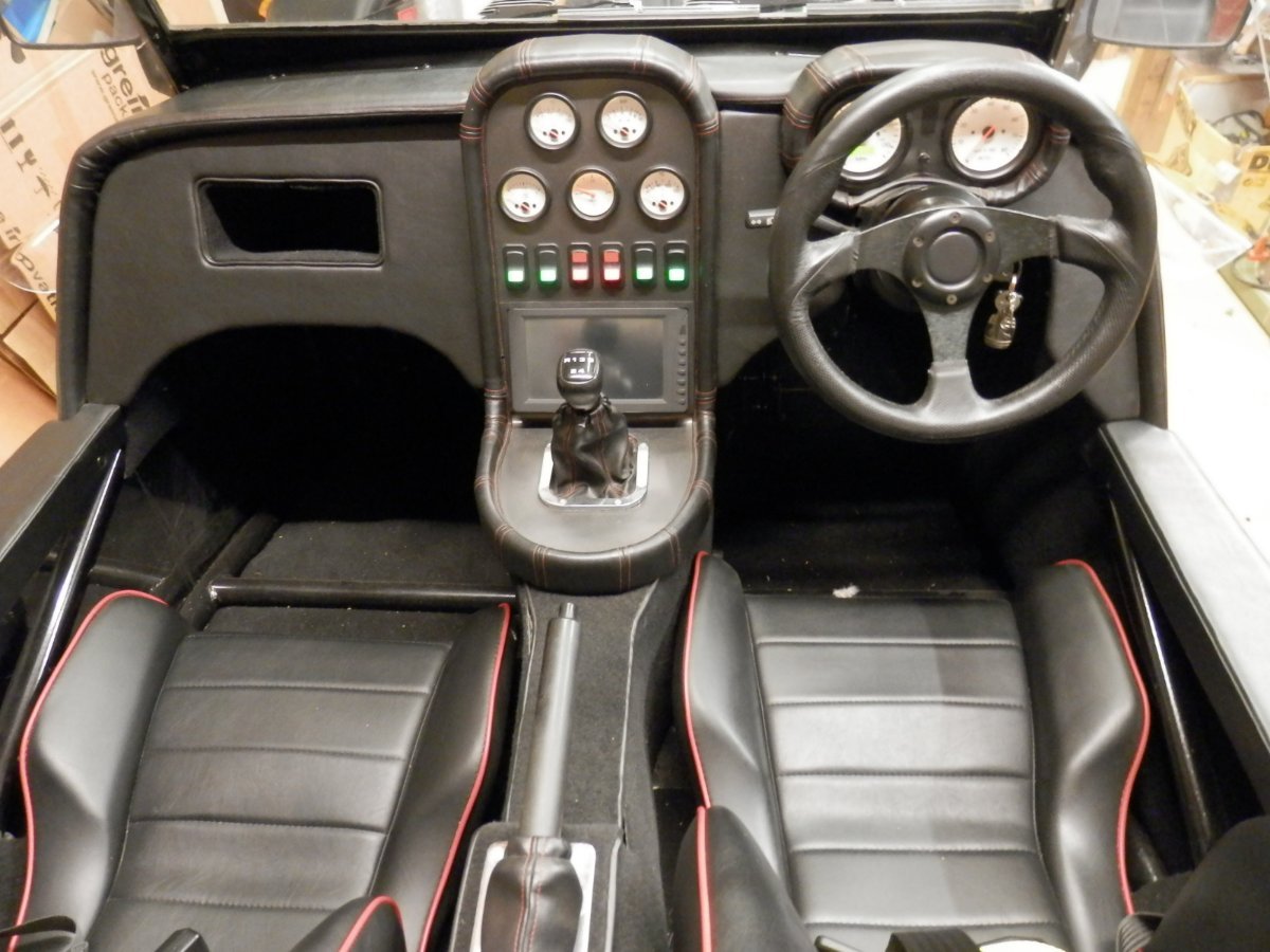

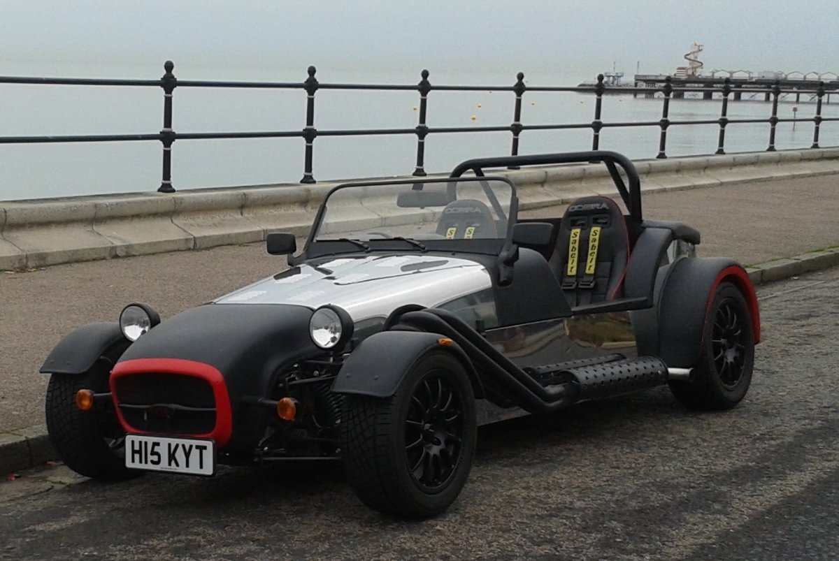

As the title says not started my hood for 3 years and now want to get it running again so I can sell it.
I intend draining the fuel tank and putting in fresh petrol, do I need to strip down the 2 webers DCOE or any other suggestions before I try turning it over.
It's a 2ltr silver top
Any help or advice greatly received or if you are in the Medway area please call in.
