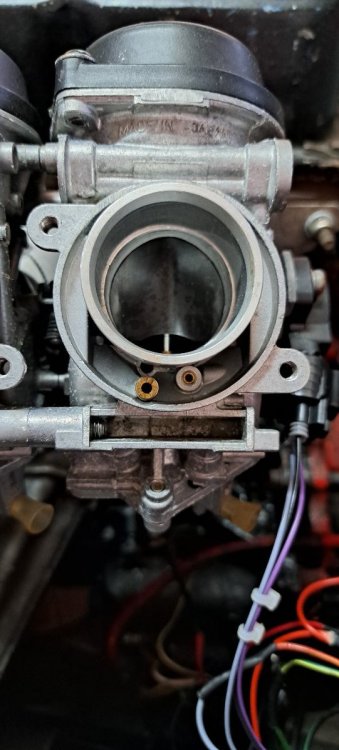

Also, are you testing with engine cold? I tested mine cold recently (with sliders lifted & WOT) and got readings of 10 bar (~145psi) across all 4 cylinders, but I remember they were about 12 bar when engine was hot.

Tested this afternoon again with sliders held open, made no difference.
Yes, testing with a cold engine.
I got the dial indicator out again on the inlet valve to double check if was fully open at 108deg. Looks to be spot on.
