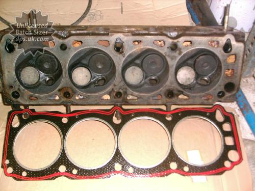

Engine is a 2.0Efi, but the water holes in the gasket (size and number off) do not match up with the cylinder block or head. Local motor factor is adamant this is right gasket for this pinto but am not entirely convinced and would like to "Ask the audience"
I had a gasket like that, t where the water channels have to go though a 'hole punch'size hole..
I am curently running a similarly designed (tiny water holes) gasket on my HC 1800 (10.7:1 !!) I went around all the channels with Hylomar to aid sealing, and since have had no problems, not even over-heating .

I've got an unused 2.0l one made by FAI
Looks just like yours (same number and position of the little holes)
Only difference is that the line of red "sealant" is only a single line and is on the other face of the gasket

as i'm typing I have next to me a head gasket made by FAI Autoparts. It is part number HG 110 and is equivalent to AH 860 from other manufacturers.
I bought this from the auto distributors I work for after extensive computer checking and book/data cross referencing.
It is identical to the one in your picture, EXCEPT the sealant material is on the other side.

This gasket is from SASO, Harrow, middx number SCH865. Main concern is that quite a few of the water ports have no hole to flow thro. Bought another cheapo from EBay and it,s the same
Don’t worry about that its normal even the Ford ones are like that it was just the red stuff I was commenting on. Look on Tak's site he has a picture with 2 gaskets on it and you’ll see what I mean.
Guest Russler
don't mess with the holes they are specifically designed like that to control the flow through the head, too much cooling and you lose efficiency etc.... ;)
oh and be careful if you use hermetite or whatever as it is good for blocking the water passages as the head tightens.
Don't mess with the water holes, the red lines around the outside is sealant that will break down and "seal" the gasket once hot. Don't put Hylomar or any other sealant on a head gasket, both surfaces should be perfectly clean and dry. clean & dry out the bolt holes as well, or when you put the bolts in, any oil etc, that's in them will contaminate your gasket seal.
The gasket shown is a reasonable good one, you can get "better" ones that have the red lines of sealant around all the bolt holes etc. as well, but you pays your money.
make sure that you torque the bolts down to the correct values, as there are 2 distinctly different values depending what bolts you use, get it wrong, and you'll be doing it again in a few weeks!

I wouldn't adjust any of the holes on the gasket could make the water decide to seep through and break the gasket away in the very small gap between head and block.
I've just put my head back on but bought a cheap head gasket set from motor factors just for the inlet and exhaust thermostat and that, but spent a bit extra on a decent one from burton power.
You can see the difference just by looking. The one from burton has extra metal between the cylinders where as the ford one and cheap one did not.
Guessing this will help as my engine blew the gasket between cylinders 3+4 and just had a standard ford gasket when taken apart. Also the ford one is 40thou thick and the one that burton recommended to me was 47thou thick. (may not be right for everyone mine has a stage 3 head and was skimmed 10thou more)

i changed on mine just few days ago and it was like yours not all the holes matched and few of them were blocked but was told by my next door mechanic (they beeen there for 30 years) that it is not necessery and they do block holes as they use these heads on many engines so it depends on ur engine size.. hope that helps.

40 thou standard gasket???
Ford standard was 1.65mm 0.065"
Reinz (Cosworth) 1.27mm 0.051mm
Felpro or the larger Adjusa 1mm 0.04mm
Yes some holes are blocked and other smaller than the holes in head or block
Sealant helps with older heads and blocks, Cometic gaskets need very flat surface to seal
