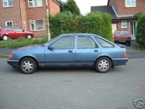

:) i think im right,but just checking,does this car have a lsd,the guy has ended the auction for me,and im collecting on saturday
e-bay link
The 4x4 2.8 should have a 3.62 LSD VIN plate should say U
On the diff tag there will be some numbers/letters (look at the top row),
EG. 83BG MC 362
Next is the middle code in this case its 'MC' which is an 'OPEN' type diff (NON-LSD) basically ANY diff with 2 or more "A" in the middle code will be an LSD e.g. "AA" or "ADA" any other letters without an "A" in the code IS an open diff.
the numbers, 362 which is (simply) 3.62:1 ratio.
Info from Nigel.
