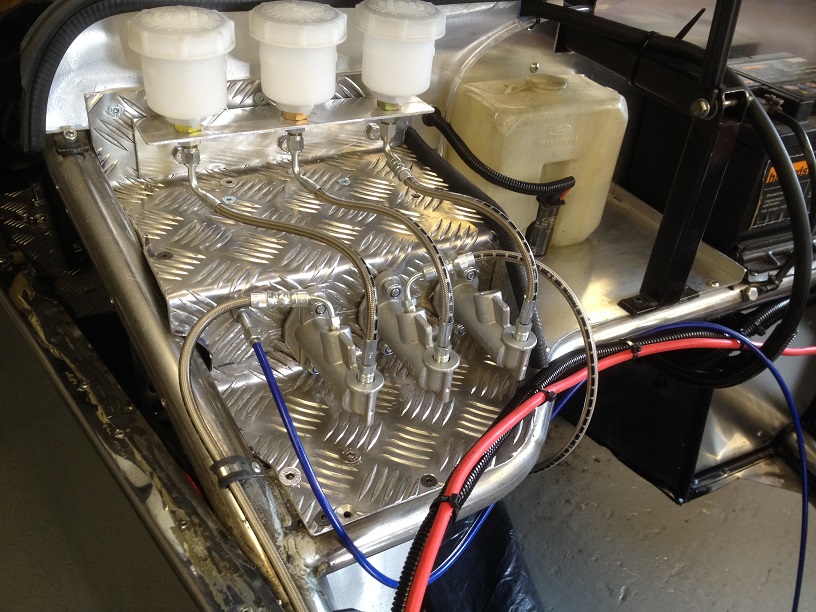

  15. Grim, my good friend. It all stems from the MOT and front and rear brakes not being up to scratch for the 240bhp engine. The tester failed the car and recommended I upgrade to better brakes or at least fix the problem with the rear drums not working....(leaking cylinder). So to get it thru the MOT I was going to clean the drums, replace both cylinders and bleed system as the springs, shoes etc. are still very good and were updated in 2013. No matter how hard I hit the brakes it will not lock up (which I would expect when intentionally trying too) and not very responsive compared to the rest of the car. Nikki and myself are very happy with the firm feeling (ooeer missus) and this is not an issue, not even had enough road time to experience brake fade from heat. But my 2 tonne 4x4 is more responsive and that takes a lot of effort to slow down, and this is a quarter of the weight and takes a lot longer to stop with effort. No Servo, but brake set-up looks like this:
