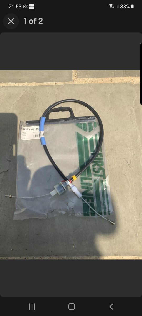

    Clutch cable
    The replacement 2wd Cosworth clutch cable fits great,in the past I've had struggles with getting the standard cable to racket up, I think because of the sharp angle via in-between manifold, just put the cossy cable on 2 pushes of the pedal started the car and in went into gear smooth as butter,thanks for recommending the cossy cable,the old cable been on a year,I'd heat wrapped it made a bracket to keep away for manifold just looked at it and it's melted and seized.

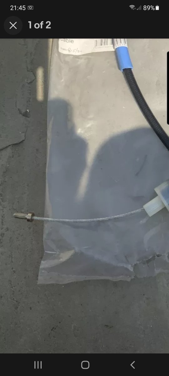

    Does it look like this racket end? Then a smaller one clutch end,I've had a couple cables I bought that were wrong,I just assumed classic ford cables would all be the same but there not.

    Just ordered the QCC1585 cable from Burton power,cost £30 but hopefully fingers crossed.

    Cheers great help

    Is this a longer cable ? Found one on Burton power doesn't say if its a bit longer though.

    Any help?running a pinto and I keep going through clutch cables more than I'd like,its due to it running between the manifold,I've heat wrapped the last one but still after near on a year its starting to become hard ( after a run and warm) to get into reverse gear without a clunk!! as the cable stretches. Struggling to find a extra long cable as it's a 82-84 and it's the cable with little T style ends,plenty out there with the eyelet type/ adjustable. Or is there any companies out there that make cables up.
