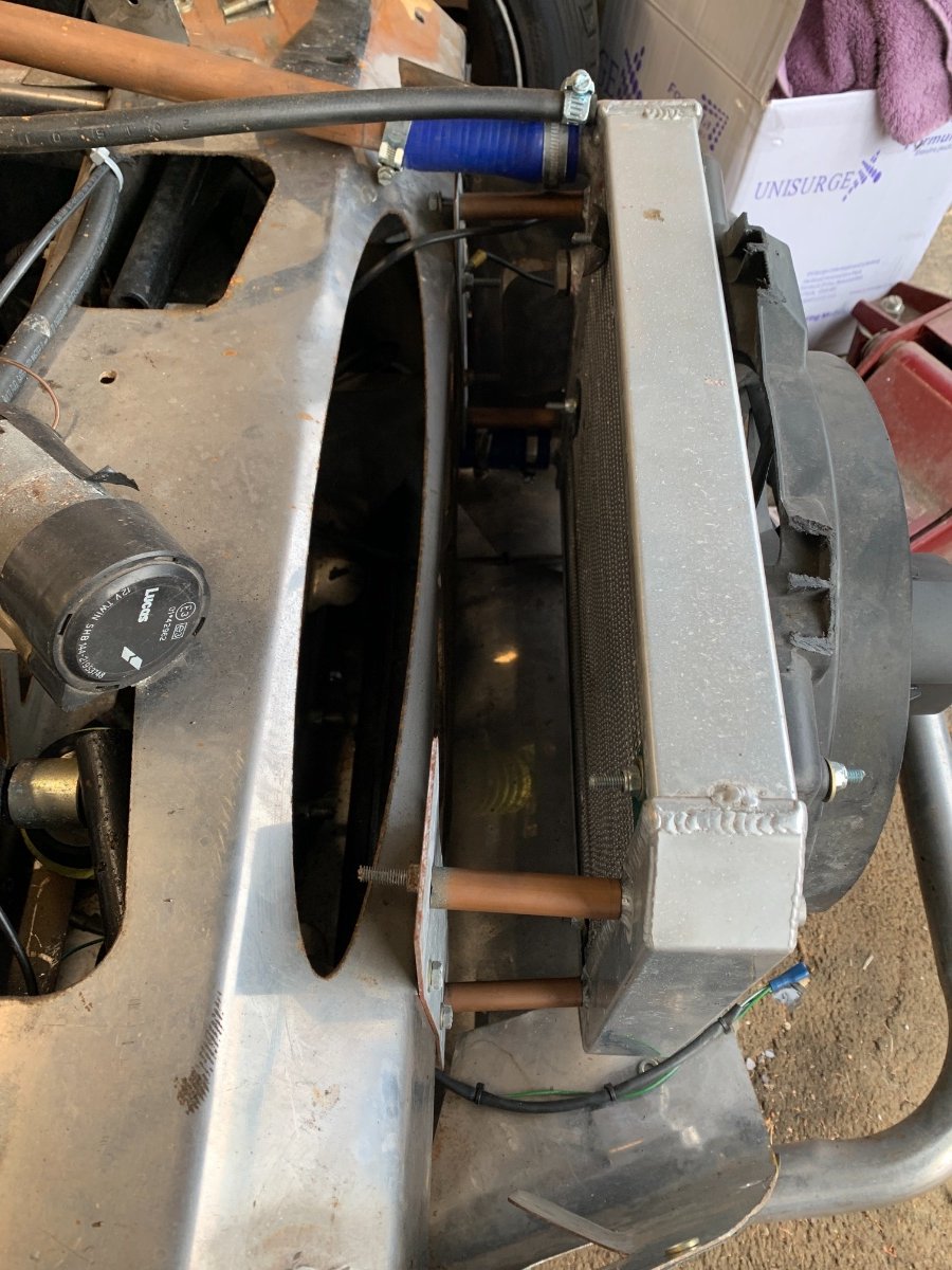

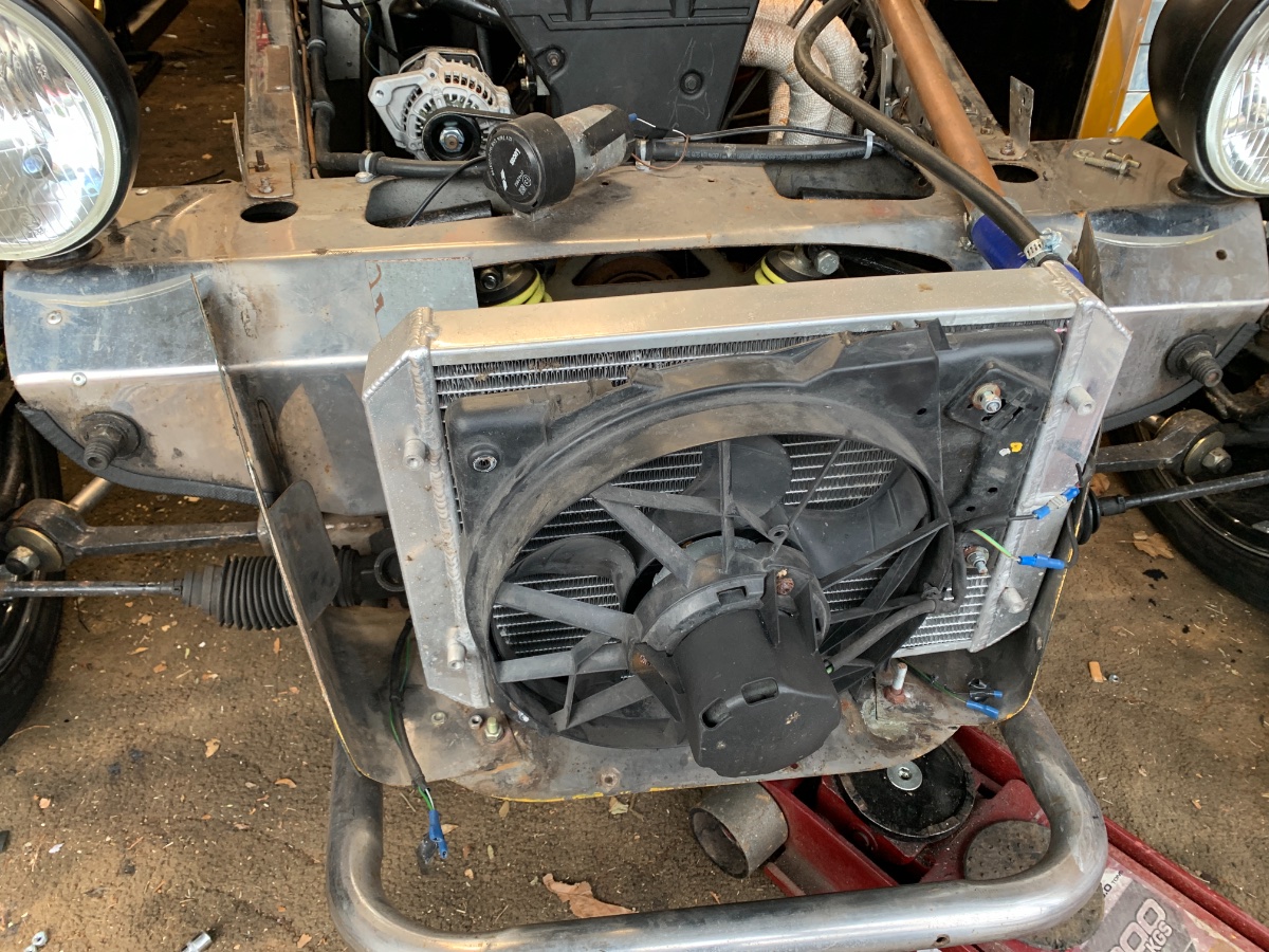

Has anyone any pictures of how their radiator is mounted.
The new rad has a couple of lugs on the bottom, so that side of thing is relatively easy. However I’m not sure how to mount the top as there is no obvious mounting point
Thanks

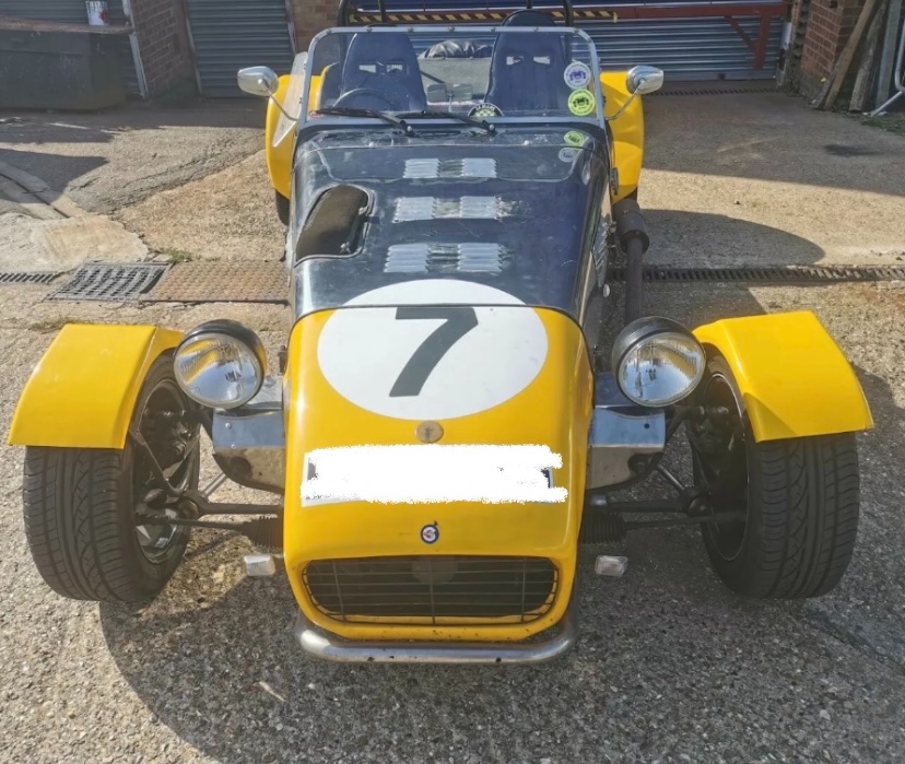

So after a hiatus of 18 years I've returned to kit car ownership, I had a GTM Rossa as my first ever car - but not knowing one end of a spanner from another it didn't end well.
I purchased this 3a off of ebay on Saturday. It looks good but in reality the MOT isn't worth the paper it's printed on! I wanted a project and have definitely got one.
I wondered if anyone on here knows/knew this car...I have a copy of an ebay sale from 2012 when it was immaculate. It is also covered in RHOC stickers from 2010 (it even went to Le Mans) - one of the previous owners was clearly an avid owners club owner.
Sadly the last 8 years haven't been kind...the car has been used, abused and somewhat neglected. I'm looking forward to getting her back to former glories.
