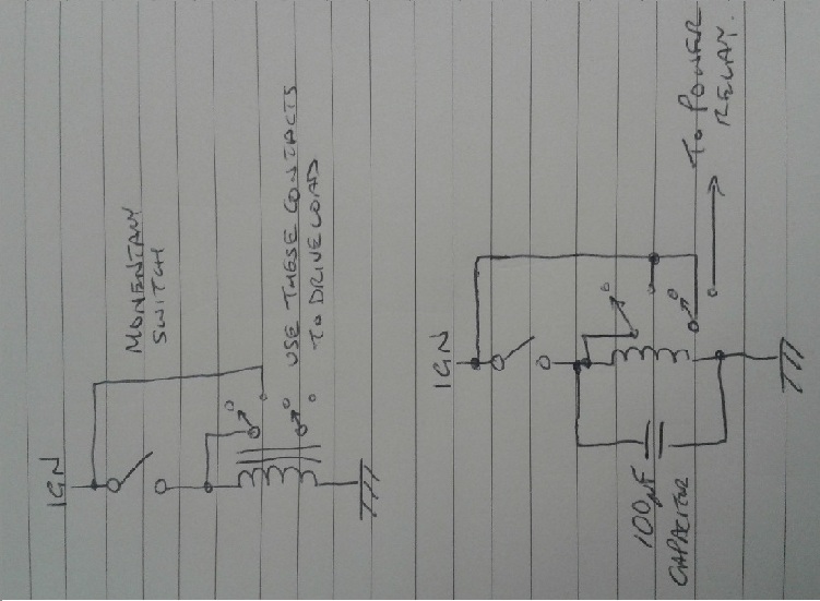

  25. Hi Joe, It may well be dificult to find such a switch and probably expensive if you do. You could do what you want with a momentary switch of your choice and a Relay. I have attached a picture of how to do it. However, there are some issues that you would need to be aware of. In the first diagram, when you push the switch the relay will energise and close the contacts, which will then cause power to keep feeding the relay and hold it on. You may find that if you don't push the button for long enough the relay will not latch. Also if there is any dip in the voltage, it may cause the relay to drop out unexpectedly. The recomendation would be to NOT use a power relay for this and instead use a lower power relay say one from Maplins and have it feed the power relay. The Capacitor accross the coil can then be used to store energy should the voltage fluctuate and stop the relay from dropping out before you need it to. Nige
