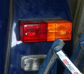

Has anybody got a spare rear light cluster lens or the reflector from the middle they are willing to part with, I'm not in a rush, just want to tidy the rear and get rid of the bike reflectors I used to get through the last MOT.

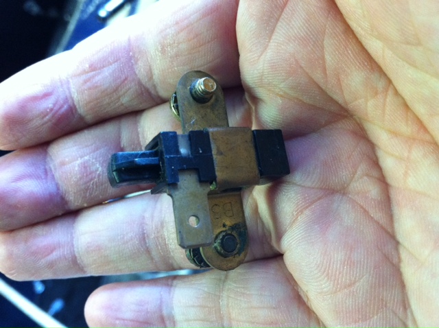

I'm also after a working hand brake switch off what I believe is the original sierra hand brake.

Wanted - Rear Light Lens And Handbrake Switch
in Wanted
Hi thanks for the quick reply, how much do you want for the lens? I had thought about using a door switch but thought i would try my luck first as i don't any of them that work either!
