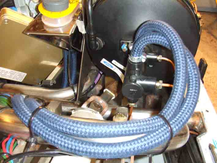

  7. Finished mine off now. No leaks (yet!) Only had to buy the flexi pipe for c£10 from burtons. The pipe is sold as suitable for brake fluid, so hopefull that will be enough to keep the sva man happy.

    Bledin' Brakes
    Latest update.... I bought an easibleed kit. It didn't come with a cap that fitted to the remote reservoir, so I had to make one. Took ages, but with g-clap, more tubing, and some sealant got a solution that worked perfectly. Really like this method, but unfortunately didn’t get any more air out. Then took out the rear nipples and but them straight into the master cylinder. Couldn’t do this with the fronts as the nipples are different sizes. Still no really firm brake though. (Checked front callipers, and bleed nipples at top). Tried to buy some larger nipples from halfords, but they don’t sell nipples at all – will have to try and find a motor factors, I guess. Then I can isolate the master cylinder. I’m now starting to think it’s either 1 – master cylinder. Trapped air that I just can’t get out, or it’s just knackered (but I be surprised if it was, as it’s new). Is it possible to check this? Can I just try to take it apart? 2 – trapped air in the pipes between the remote cylinder and the master cylinder. Would this cause a problem? The route of the pipes does go up and down, but not sure if this would be an issue? Any more thoughts appreciated! James

    Arghhh, getting frustrated now! Just spent over two hours messing with the brakes and still not there. Cleaned the front offside nipple and seating, and that appears to function correctly now. So, with the engine off, the pedal appears pretty firm. (Although, if I put ALL my weight on it and jump up and down, it does just bottom out). I thought I’d done it…….but with engine on, it easily bottoms out. So, I'm guessing there must still be some air trapped in somewhere (rather than any leaks, as the pedal always stays where it is, rather than sinking, and no visible signs of leakage). I've redone the clamping of all flexi's, and looking at each individual circuit. All appear to be the same - ie the pedal moves down very slightly more when you remove the clamp from that circuit - and no one circuit appears to cause that much of a problem. Next, I'm thinking about.... 1. Buying an easybleed kit. And letting that do some work (Mrs. H is starting to moan when helping now). 2. Trying to push the slave cylinders back in, as suggested about. Is there any technique to doing this - or should I just use some bigish claps?? I don't think it is the master cylinder (as this is brand new). Is there any thing else I should try looking at (before I start kicking it, or just decide to not bother with the servo!). Cheers James

    OK... I've been methodically clamping things up, and found the problem to be in the front offside caliper. With clap on this flexi, nice and firm (although I've not tried it with the engine on yet) and can't get pedal to floor however hard I try . But with clamp off, very spongy again. I've played around bleeding this corner, but can't seam to fix it. One thing I have noticed, is that I don't really get a good stream coming out of the nipple. With Mrs H pushing the brake pedal, I undo the nipple a little, and an initial amount of brake fluid comes out, then it pretty much stops, but comes through the threads instead Could this be a faulty nipple? Or could this be a symptom of something else? Any suggestions please..... PS clamps from wilkinson were not much cop as broke one on first use. Though I guess £2.29 for 3 g-clamps isn't going to get you much quality.....!

    I've just filled the brake system with brake fluid, and bleed them (using a one man bleed kit, and the wife too, for good measure!). I've got drums at the back, and the brakes aren't worn in yet (car hasn't moved under it's own steam). All corners are giving a good stream of fluid, without any air bubbles that I can see. However, the pedal travels all the way to the floor (even without the engine on, and servo operating). It's quite firm, but if I really stand on it, it does go all the way. I'm guessing this isn't normal. Any ideas on what I should look at first?? Cheers James
