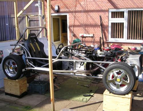

Just a minor point. You may be better leaving the floor support angle-irons till later as they need to be positioned to pick up the seat fixing bolts when you have worked out how far back to put your seats. I built 4 "plinths" from 18mm ply which were 18" high and stood the car on these. It gives good working access to underneath the car and saves an awful lot of back-ache from bending over to work on a car that is stood on the ground.

For the record, i built my 2b in this order..........
Floorpan
Rear subframe and suspension
Front suspension
Steering rack
Engine and Gearbox
Radiator
propshaft
Tunnel side (driver)
pedalbox / Steering column / servo
handbrake
brake pipes
Fuel lines
fueltank
Bulkhead
Dashboard
Wiring loom and fuse box
TEST DRIVE !
Tunnel side and top
rear panel and rear wings
side panels
Bonnet and nosecone
Windscreen
Wipers
Lights
Seats and belts.
any remaining trim etc.
Mostly I didn't ''final fix'' anything until I was certain it would not have to come off
again or be moved to suit another part.
Do everything you can on the mechanicals before fitting any bodywork.Its easier to get your hands in !
The above sequence may not suit everyone, but i had to roll mine out each time I wanted to work on it.
Good luck
