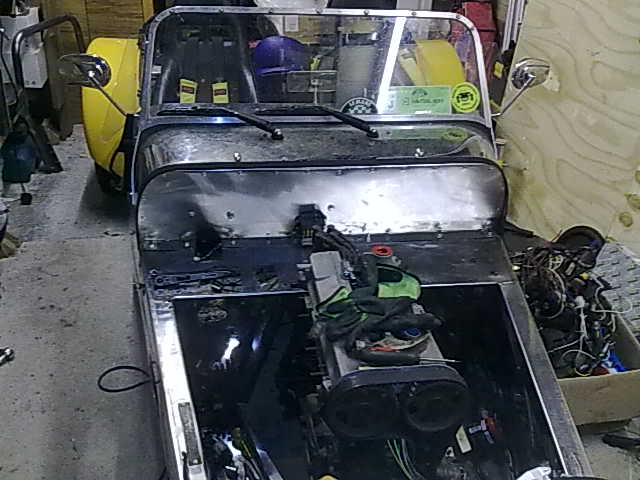

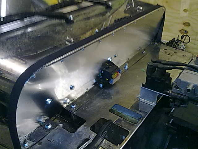

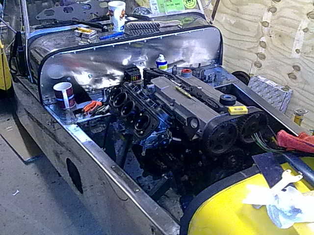

I made and fitted a new bulkhead cover, covering over all the unused and unwanted holes. Hopefully this will stop my leg from cooking again :diablo:
As and when i need to, I will only drill a hole big enough for the task, and use a grommet to help seal it.

Looking good keep the updates and picture coming. Igniting the spark for fresh ideas and motivation to get my backside into the garage.
Regards
Mark

That's made a hell of a difference Darren :yahoo: Coil pack mount looks good as well.

Yeah it looks much better doesn't it.

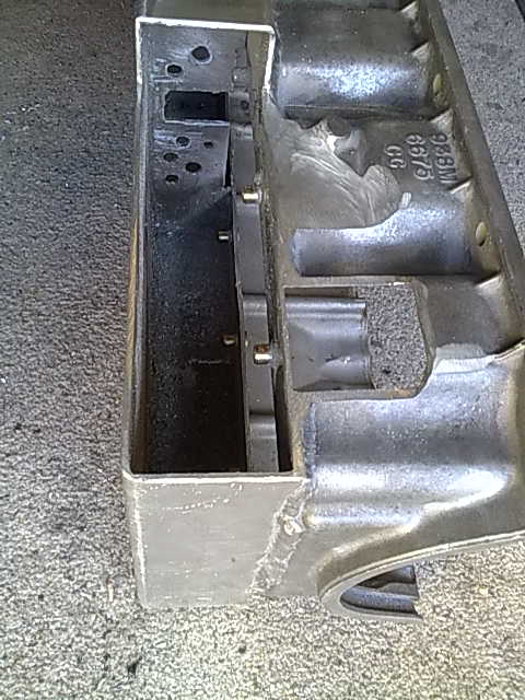

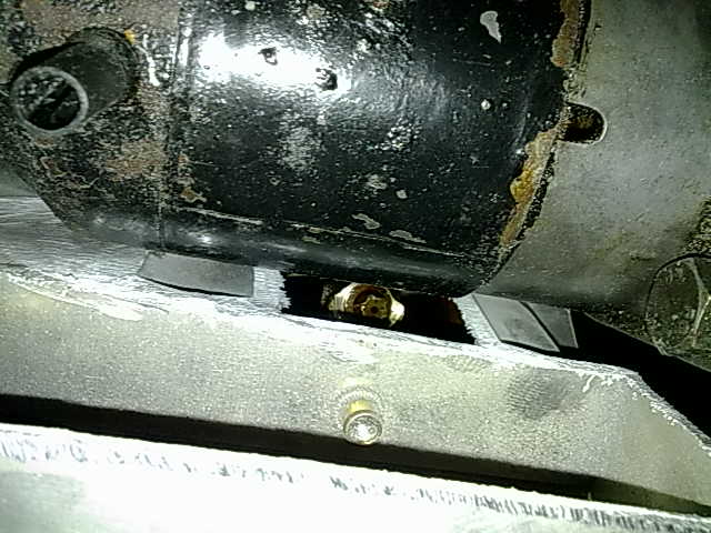

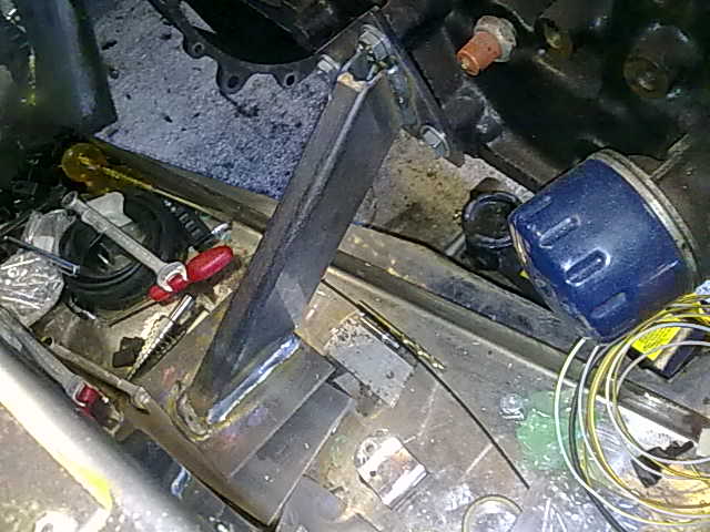

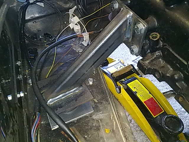

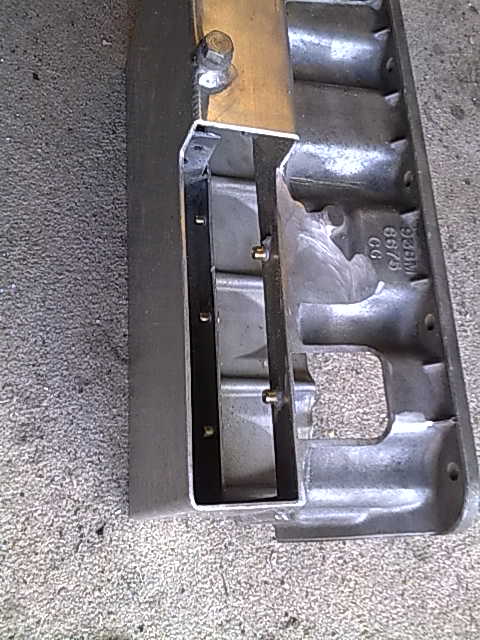

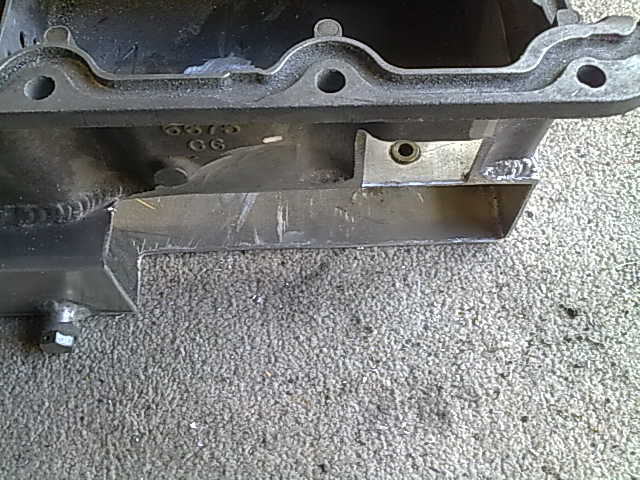

The engine is now fully supported on it's own mounts :yahoo: :yahoo: :yahoo: I managed to find a local welding company who needed a top up to their tea fund, and the welding is absolutely ace. I will post some pics later.
I also chopped the sump about and now the starter fits fine, just need to find out if the above welders can do ali, if not I have a truck builder nearby who make ali bodies, so again, I'll see if their tea fund needs topping up!

Pics as promised.
As you can see I have had to cut quite a bit off the sump, but I have kept it simple for the welder.

Here are the finished mounts, didn't get round to painting them though!
